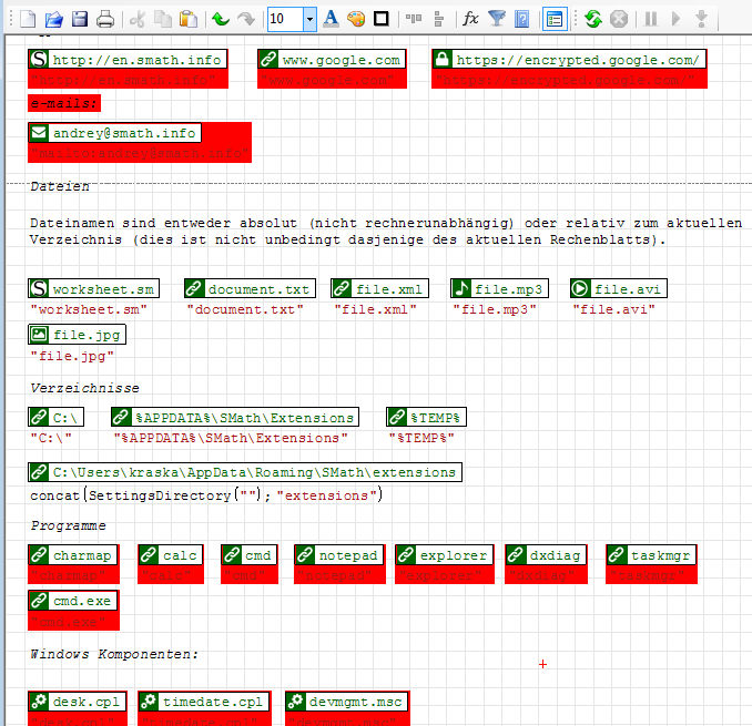

Davide, I experience strange problems with hyperlinks with SMath 0.98.6179 and a fresh hyperlink region plugin.
The links in your docs (from post #1) work fine.
If I copy them to my handbook page, I get "System can't find the file" messages for the links marked with red background, both documents in the same instance of SMath. No matter if portable or installed distribution...
There must be something wrong with my document...
WroteIf I copy them to my handbook page, I get "System can't find the file" messages for the links marked with red background, both documents in the same instance of SMath. No matter if portable or installed distribution...
Try now, it should be fixed.

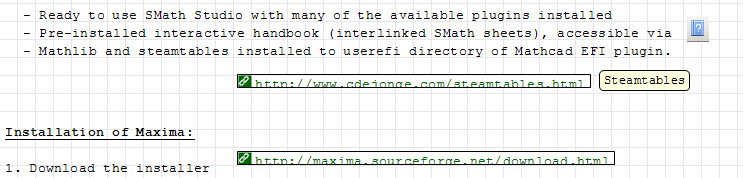

Hi Davide,
is there a way to save a pdf of an .sm file, and keeping the Hyperlink Region as a real embedded hyperlink in the pdf file?
Currently I'm saving pdfs with Andrey's tool "PDF Files Plugin", meaning that I simply select " SAVE AS ---> .pdf " from the "file" tab.
Doing this, the hyperlink Region will become an image in the pdf file.
I'm not even sure if the above requirement is related more to the "Hyperlink plugin" or to the "PDF Files Plugin" behaviour.

Hi Jean, my goal is not to reconvert.
Probably I didn't write it properly: I would like to open an sm file that contains Hyperlinks, and save it as pdf where Hyperlink Regions are still clickable links.
