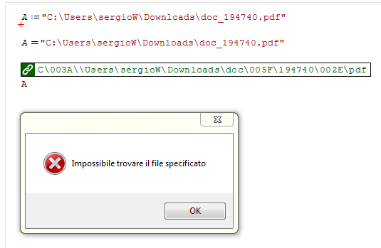

#69 Posted: 2019/6/13 05:54:44
127 likes in 342 posts.
Davide,
has been experiencing the following problem for some time now (so not only in the latest version of development available).
To generate a hyperlink quickly and without forgetting any characters, I used to copy the full name of the file to the clipboard and then copy it into smath. As shown in the figure, the simple procedure indicated is complicated by the fact that the particular characters (including the dot and the colon that are always present and in any case) are apparently well copied in smath (as seen from the string) but if applied in the Hiperlink Region , give problems.
I thank you for the attention you will give me.
#70 Posted: 2019/6/13 06:46:37
1,443 likes in 2,935 posts.
Thank you, I think I can fix it this weekend.

#71 Posted: 2019/6/15 10:12:05
Should be fixed now (plugin updated).
