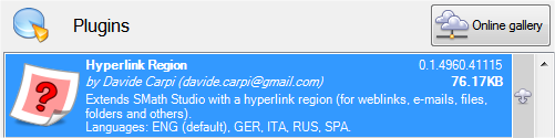

#4 Опубликовано: 31.07.2013 18:06:14
First Beta available through plugin's Gallery.
Documentation and translation sheet in the first post.
Best regards,
Davide

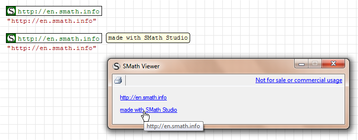

UPDATED
- Support for SMath Viewer
best regards,
Davide

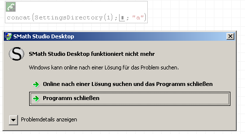

#15 Опубликовано: 09.08.2013 18:35:53
SMath crashes when I try to edit the input expression of a hyperlink.
I write concat with three arguments, fill in the first and the last. As soon as I want to type to the second placeholder, the crash occures.
#16 Опубликовано: 09.08.2013 19:07:15
Fixed, please test the update
best regards,
Davide
Martin Kraska 09.08.2013 19:34:00
#17 Опубликовано: 09.08.2013 19:35:26
That was fast... Thanks a lot.
