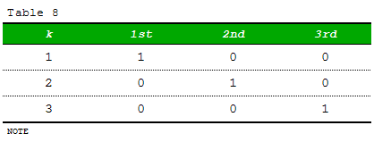

#29 Posted: 2014/2/15 17:37:37
1,308 likes in 2,221 posts.
BTW before releasing a "stable" version, I would like to have an opinion from the community whether it is preferable to have the header and footer areas extended to the stubs, or if it is better to leave them as they are
I wonder how you want to control cell alignment of the header if it extends over the stubs.
There are two features which might be adjusted a little (may be matter of taste):
- The cell dimensions are affected by settings of invisible parts. E.g. if left stub and data have their vertical padding set to zero (to get compact cells), then they still are adusted to the padding values of the right stub even if that is invisible.
- If the ellipsis is on the left side, then expanding the table to the right using the region markers is not possible (see image)
Did I get it right that the unit summary is for scaling the data by line?
BTW, I like the feature of getting rid of the region border. Would be fine for the image region as well.

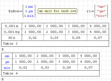

#31 Posted: 2014/2/16 08:33:09
By columns, by rows or global (single unit/scale factor)
Thanks, control by matrix dimension seems clean and easy to remember.
I'd prefer the unit summary entries not being converted to base units but rather being displayed as specified (perhaps with a bit of string processing to remove spurious curly braces and to replace ^2 by ³ and ^3 by ² )
There is, of course, a workaround by hiding the summary and writing the units as strings to the stub or header - with inherent danger of inconsistency.
I would like to add another feature request: formatting with specified number of significant digits.

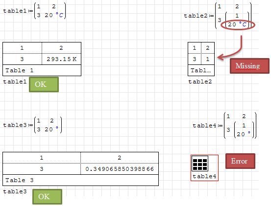

#33 Posted: 2014/2/18 05:08:42
Infinity
Infinity
3 likes in 30 posts.
I found two issues within this plugin.
- Comma ',' as argument separator does not work probably when sub matrices are used.
- The degree symbols causes issues when sub matrices are used.
Please see my attached images.
Best Regards,
Infinity
Davide Carpi 2014/2/18 09:44:00
#34 Posted: 2014/2/18 09:44:56
1,435 likes in 2,913 posts.
Thank you, I'll fix it

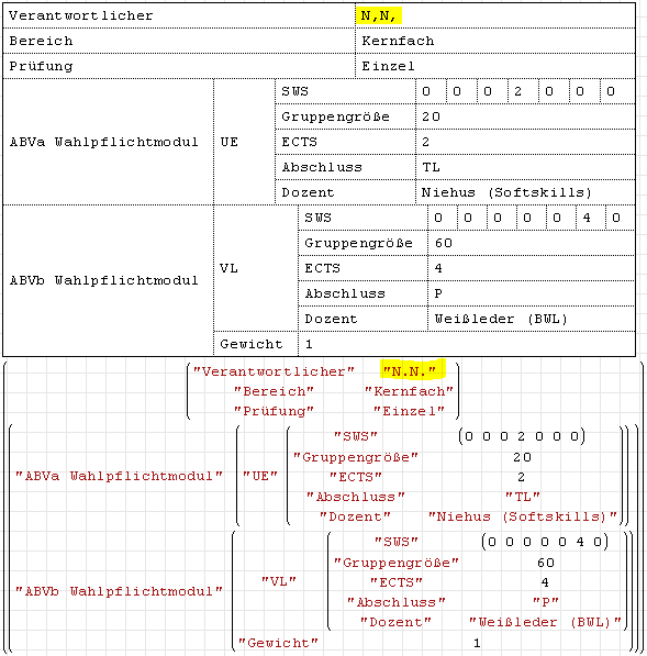

#37 Posted: 2014/4/20 06:13:15
Happy easter to the smathicians!
Unexpected results in Table Region. All but the first submatrices are collapsed to some strange number. Something went wrong...
NK TM1 13.sm (38.49 KiB) downloaded 919 time(s).
Davide Carpi 2014/4/21 13:36:00
#38 Posted: 2014/4/21 13:38:50
Thank you Martin, bug added in the BTS (SS-120)
Best regards,
Davide
Martin Kraska 2014/4/21 15:53:00
