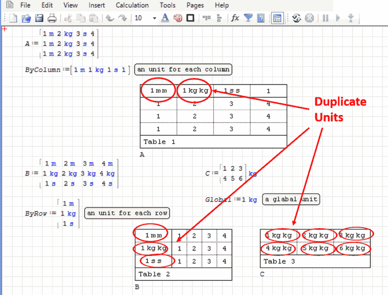

Why units are duplicate in Table Region?
units (1).sm (21.03 KiB) downloaded 1505 time(s).
Carlos
Carlos
It's a bug
thank you for reporting, I'll fix it ASAP.

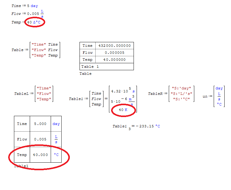

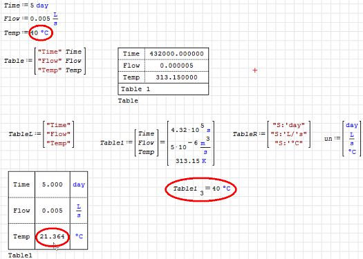

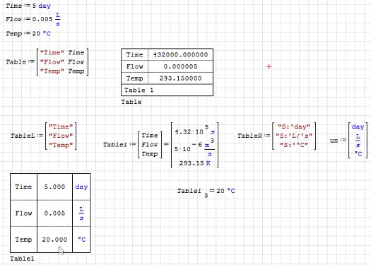

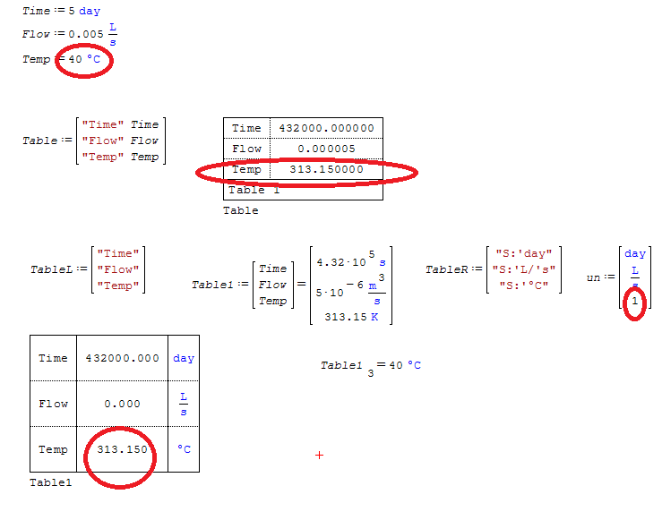

I observe a peculiar behavior when "Temp" is changed from 20 Celsius to, say, 40 Celsius.
See how the table value responds when input "Temp" is changed to 40 Celsius.
Where have I gone wrong? Apparently, this happens only with Temp units (needs further checks).
Units_Table_r2 (1).sm (17.27 KiB) downloaded 1381 time(s).

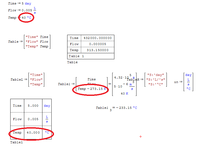

This seems to be related to offset between Celsius and Kelvin.
I can produce the correct output (with incorrect input) by changing units of Temp to Δ°C OR by changing value in Table1 to Temp-273.15K.
Note that by setting the units in the un column to 1 from °C, the temperature is shown in Kelvin as the first table in the .sm.
Somehow the conversion from K to °C is not being performed properly within table region.

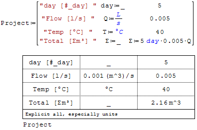

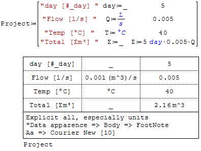

WroteWhere have I gone wrong ?
Not easy to get Table that makes sense ... kind of pest !
Table Region [Project].sm (7.85 KiB) downloaded 1242 time(s).

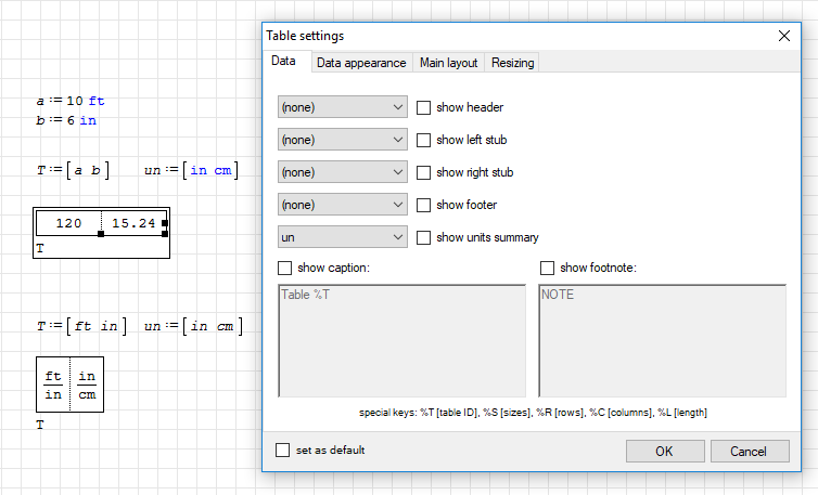

alyles,
The way the unit summary matrix works is that it actually does a unit conversion as seen in the image below.
the "in" unit shown in the un matrix is converted to the default unit in the same way the "a" and "b" variables are. Then the un matrix divides the T matrix to cancel out the units and display the values in the units chosen in the un matrix.
In the image shown below, the 6in are converted to 0.5ft when placed into the table, then the cm unit in the un matrix is converted to 0.0328ft and divides the 0.5ft value, making it 15.24 as shown.
Note that the unit summary matrix is not being displayed. They will not display as entered into the unit summary matrix because they are converted to the default unit as explained prior.
If you want the units to display, you will need to add a right stub with the units as "S:'unit" as shown before.
