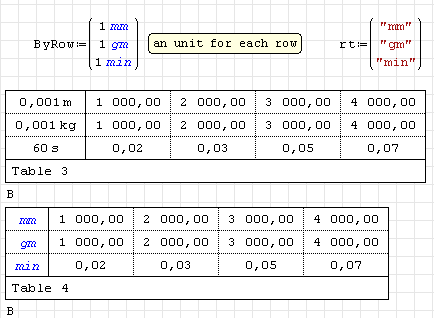

Did I get it right that the unit summary is for scaling the data by line?
By columns, by rows or global (single unit/scale factor)
Thanks, control by matrix dimension seems clean and easy to remember.
I'd prefer the unit summary entries not being converted to base units but rather being displayed as specified (perhaps with a bit of string processing to remove spurious curly braces and to replace ^2 by ³ and ^3 by ² )
There is, of course, a workaround by hiding the summary and writing the units as strings to the stub or header - with inherent danger of inconsistency.

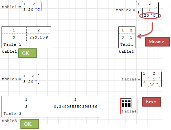

I found two issues within this plugin.
- Comma ',' as argument separator does not work probably when sub matrices are used.
- The degree symbols causes issues when sub matrices are used.
Please see my attached images.

Davide Carpi 2/18/2014 9:44:00 AM
#34 Posted: 2/18/2014 9:44:56 AM
1,443 likes in 2,936 posts.
Thank you, I'll fix it

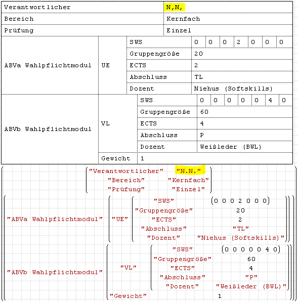

Unexpected results in Table Region. All but the first submatrices are collapsed to some strange number. Something went wrong...
NK TM1 13.sm (38.49 KiB) downloaded 1685 time(s).
Davide Carpi 4/21/2014 1:36:00 PM
#38 Posted: 4/21/2014 1:38:50 PM
Thank you Martin, bug added in the BTS (SS-120)
