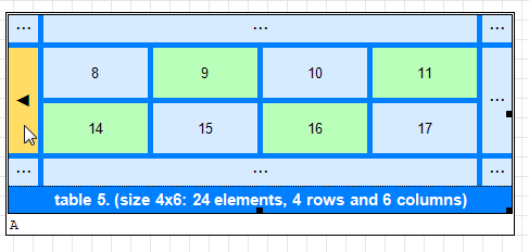

Is a region that show a SMath Studio numerical variable as written in a table; basically is an image, the look is customizable using the context menu (a cell editor like excel is too complicated to make for me); as for now there's only the body, I'll try to add other things (those shown in the dialog above and schematized below (colored boxes are all "optionals", as general idea); the hardest thing will be surely unit's handling ...
