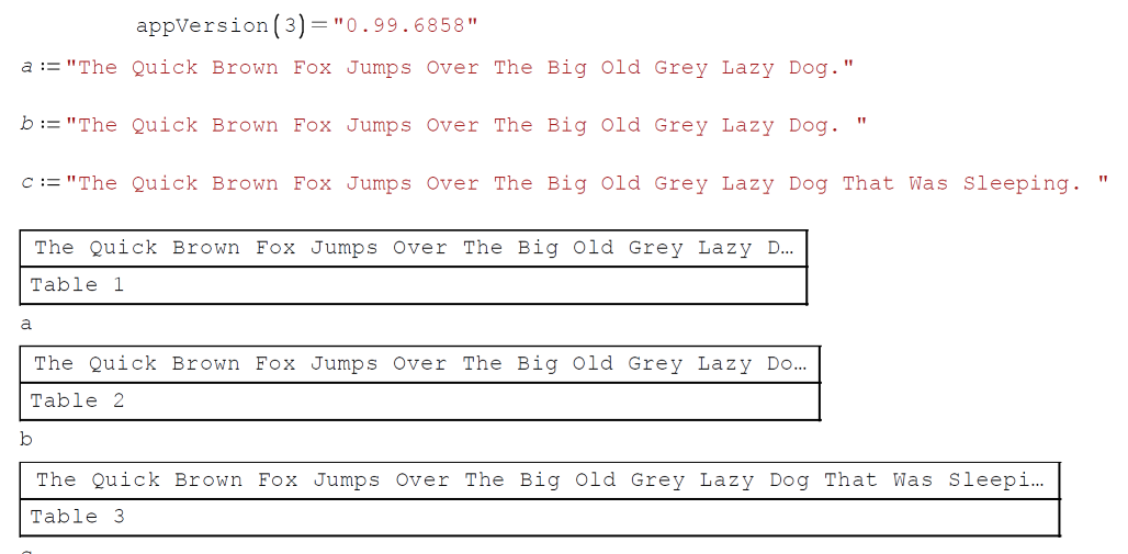

I wish it where that easy. Unfortunately, as previously discussed, as the number of characters increases, the more blank spaces you need to add in order to display the full text. In my particular situation, I am dealing with thousands of different lengths, having to figure out exactly how many spaces to add to the end hardly seems like a "solution," but rather a work around... which was also previously discussed.
Here is an example of what I mean. "a" has no space, while both "b" and "c" have each one space. As you can see "b" has 3 missing characters counting the blank space on the end, while "c" has 4 missing characters.
Perhaps there can be a way of counting the characters in a string and then having some concatenating function add the spaces automatically depending on the length?? Just a thought...

So... I did some testing and here are the results.
String Length....Spaces Needed at end to display full string
1-12...............0
13-46..............1
47-70..............2
71-94..............3
Every +24.........n+1
If printing portrait mode, default font size you wont need more than 3 spaces.
Landscape mode will need 5 with default font size.
For those who are interested...

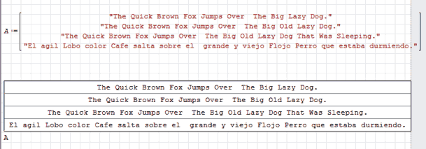

I do not know what your objective is, the case I described was for use in titles, otherwise, you can use
a matrix without worrying about using spaces as in the example below.
Table_Space_1.sm (6.68 KiB) downloaded 1343 time(s).
Carlos

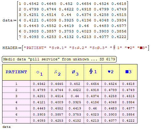

Hi, Davide!
I'm trying to use UNICODE symbols in tables, but they just don't work. I get \numbers\ instead of the actual symbol.
Is there another comprehensible set of symbols I could use inside this region?
Thanks!

#100 Posted: 2020/8/24 08:16:04
Is there another comprehensible set of symbols I could use inside this region ?
In the mean time: from Win Charmap.
sergio 2020/8/24 09:48:00
