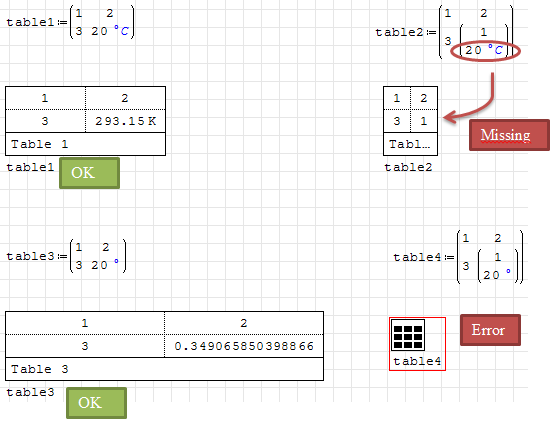

There are two features which might be adjusted a little (may be matter of taste):
- The cell dimensions are affected by settings of invisible parts. E.g. if left stub and data have their vertical padding set to zero (to get compact cells), then they still are adusted to the padding values of the right stub even if that is invisible.
- If the ellipsis is on the left side, then expanding the table to the right using the region markers is not possible (see image)

Oh, that's a nice question, because I have absolutely no ideas about this, it's just a stone dropped in the pond :d
Thank you (sizes balancing on invisible zones - fixed); I'm not sure if synchronizing vertical paddings we loose some features (when there are different font settings) so, as for now, I've left this untouched.
I'll think about this, actually I don't have ideas on how to handle by code the top/left resizing... as for now a way is to use "expand to table limits" feature and then, if needed, "shrink to page size"

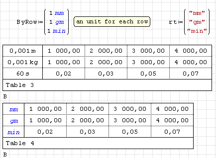

Did I get it right that the unit summary is for scaling the data by line?
By columns, by rows or global (single unit/scale factor)
[edit] attachment updated using the latest plugin's XML scheme

#31 Опубликовано: 16.02.2014 08:33:09
Thanks, control by matrix dimension seems clean and easy to remember.
I'd prefer the unit summary entries not being converted to base units but rather being displayed as specified (perhaps with a bit of string processing to remove spurious curly braces and to replace ^2 by ³ and ^3 by ² )
There is, of course, a workaround by hiding the summary and writing the units as strings to the stub or header - with inherent danger of inconsistency.
I would like to add another feature request: formatting with specified number of significant digits.
I know... As I've written before, actually there's no way to do this directly...

I found two issues within this plugin.
- Comma ',' as argument separator does not work probably when sub matrices are used.
- The degree symbols causes issues when sub matrices are used.
Please see my attached images.
Best Regards,
Infinity
Davide Carpi 18.02.2014 09:44:00
#34 Опубликовано: 18.02.2014 09:44:56
Thank you, I'll fix it

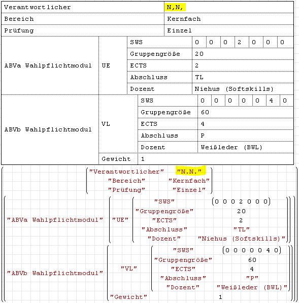

#37 Опубликовано: 20.04.2014 06:13:15
Happy easter to the smathicians!
Unexpected results in Table Region. All but the first submatrices are collapsed to some strange number. Something went wrong...
NK TM1 13.sm (38,49 КиБ) скачан 1685 раз(а).
Davide Carpi 21.04.2014 13:36:00
#38 Опубликовано: 21.04.2014 13:38:50
Thank you Martin, bug added in the BTS (SS-120)
