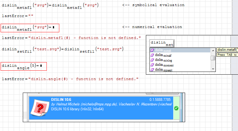

#4 Опубликовано: 14.02.2016 14:49:05
Thank you Viacheslav, disabling the recalculation I can save your example and I experienced some small improvements (still doesn't works):
Files (worksheet, log, output svg): DISLIN.zip (19,63 КиБ) скачан 613 раз(а).
"Functions not defined":
Aside note, crash occours if the output directory doesn't exists;

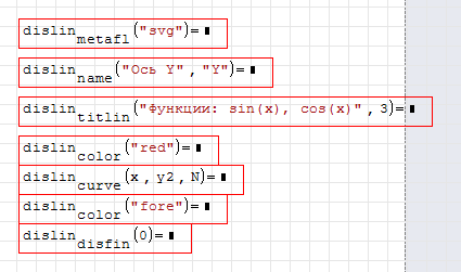

#5 Опубликовано: 14.02.2016 15:01:02
I forgot to say that you should not save the file! Look at the contents. Function names lost prefix. Therefore it is necessary to follow exactly what I write.
1. Restart SMath Studio.
2. Turn off autocalc.
3. Do not save the worksheet!
4. Enter functions line by line, don't forget to add = (do not press F9!).
dislin.metafl("svg"
dislin.setfil("d:\\file.svg"
dislin.errdev("file"
dislin.errfil("d:\\out.txt"
dislin.filmod("delete"
dislin.disini(0)
dislin.disfin(0)
5. Now you can press F9.
EDIT: The library interface is ugly. You must read the user manual before continuing experiments. The order of calling functions is important.

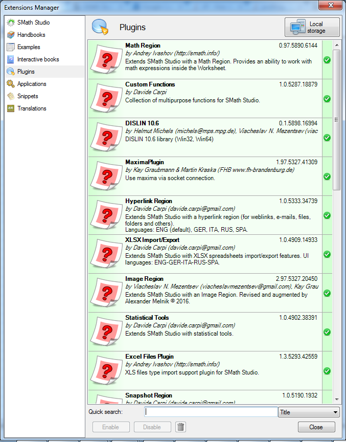

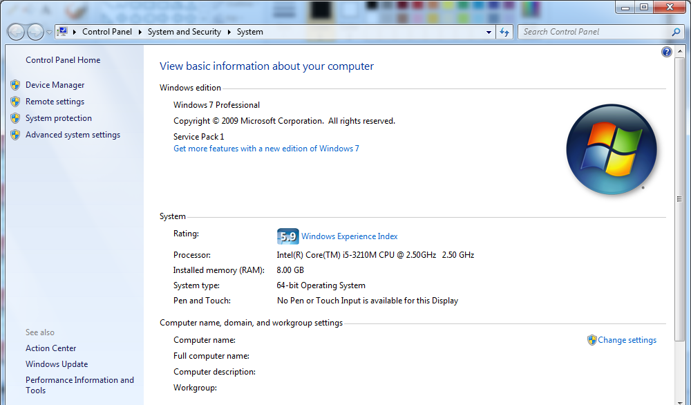

Strange on my system Smath crashes and I am forced to close the program.
The release installed is
Working under Windows 7 Professional
Franco
