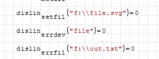

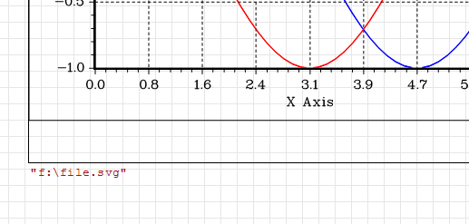

Succeeded cut and pasting in the placeholder "c:\\file.svg".( but just by chance ..to tell the truth I was trying with the Import method ..but no result ..there is still something not clear to me )

Hello Franco,
In my notebook I've not unlocked the privileges for "C:\" so the file crashes, but using another path where I have the privileges you have to use simply that path (standard, without double backslashes).

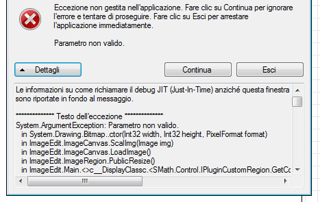

BTW I can't resize the image from the context menu of the Image region, an hard crash occours
Please report any Image Region bugs to the plugin thread (together with offending file) - I will definitely investigate this.
I have quickly checked "reset size" on a variety of .svg (both embedded and linked) and they work well

Davide,
I have tried to enter a normal path without succeeding probably I am a beginner and I am not able to enter a simple path in a placeholder too.
So not being able to do this I tried the brutal approach of the copy and paste of the path from the first DSLIN instruction and it is with a double quote ..and it worked fine ; probably it is a feature of the image plug-in that is undocumented.
Then I started to play with the image turning it and was OK than I probably played with the size handle and had your same issue .
To make other testing I was forced to reload the file from the UNI e-mail and restart from scratch.
Franco
Hi All,
I would love to make the Image Region handle DISLIN properly, however I was not able to come up with a fix myself.
From what I understood, the SVG engine (https://svg.codeplex.com/) has trouble reading Height/Width of the .svg produced by DISLIN. If any of you guys need the functionality enough to investigate and come up with a solution I would love to implement it in the code of the Image Region.
The svg file doesn't contain viewBox attribute. The ImageRegion plugin could check its availability and if it is not, then add your own:
<svg width="100%" height="100%" viewBox="0 0 800 800" xmlns="http://www.w3.org/2000/svg">
<svg width="100%" height="100%" viewBox="0 0 800 800" xmlns="http://www.w3.org/2000/svg">[/code][/quote]
After many-many attempts (I have literally spent good 6 hours to fix display of DISLIN svg) I have found the "correct" way of fixing the missing viewport parameter.
Plugin was updated.

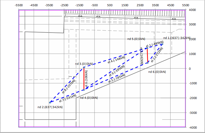

What is the most encompassing example do you guys have on using DISLIN for 2D plots?
I need to plot a set of straight lines and single points (up to a 100 or so, each is a separate dataset) and am looking for:
- setting the color of each single line
- setting the line type / weight of each single line
- adding a label to each single line
- adding a label to each single point
- precisely manipulating the height / width / position of plot area (independently of the size of the resulting SVG
- adding legend
- adding grid lines
I am aware that a few of the points above are covered by sine/cosine plot from earlier... I am just looking for the most all-encompassing example you guys have.
Thanks!

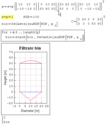

I'm just instrumenting a filtrate bin, rough work.

As usual, a picture is worth a hudred words... This is what I would like to get at the end (excluding background graphics), without using EXCEL of course. Each node and line is a separate function.
