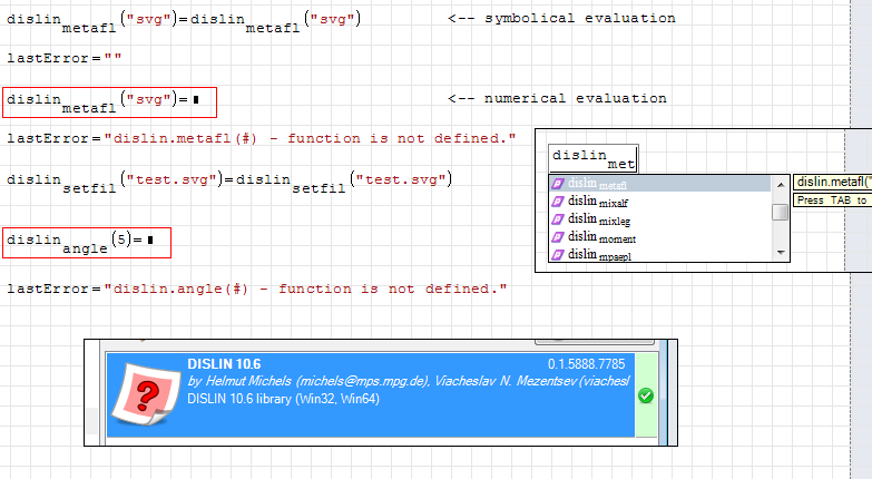

#4 Posted: 2/14/2016 2:49:05 PM
Thank you Viacheslav, disabling the recalculation I can save your example and I experienced some small improvements (still doesn't works):
Files (worksheet, log, output svg): DISLIN.zip (19.63 KiB) downloaded 613 time(s).
"Functions not defined":
![2016-02-14 18_44_49-SMath Studio Desktop - [Page2_].png](/en-US/files/Download/Dvao5P/2016-02-14-18_44_49-SMath-Studio-Desktop---[Page2_].png)
Aside note, crash occours if the output directory doesn't exists;

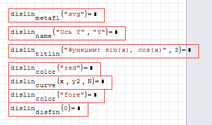

#5 Posted: 2/14/2016 3:01:02 PM
I forgot to say that you should not save the file! Look at the contents. Function names lost prefix. Therefore it is necessary to follow exactly what I write.
1. Restart SMath Studio.
2. Turn off autocalc.
3. Do not save the worksheet!
4. Enter functions line by line, don't forget to add = (do not press F9!).
5. Now you can press F9.
EDIT: The library interface is ugly. You must read the user manual before continuing experiments. The order of calling functions is important.
dislin.metafl("svg"
dislin.setfil("d:\\file.svg"
dislin.errdev("file"
dislin.errfil("d:\\out.txt"
dislin.filmod("delete"
dislin.disini(0)
dislin.disfin(0)

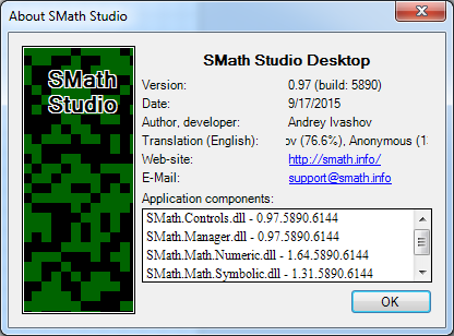

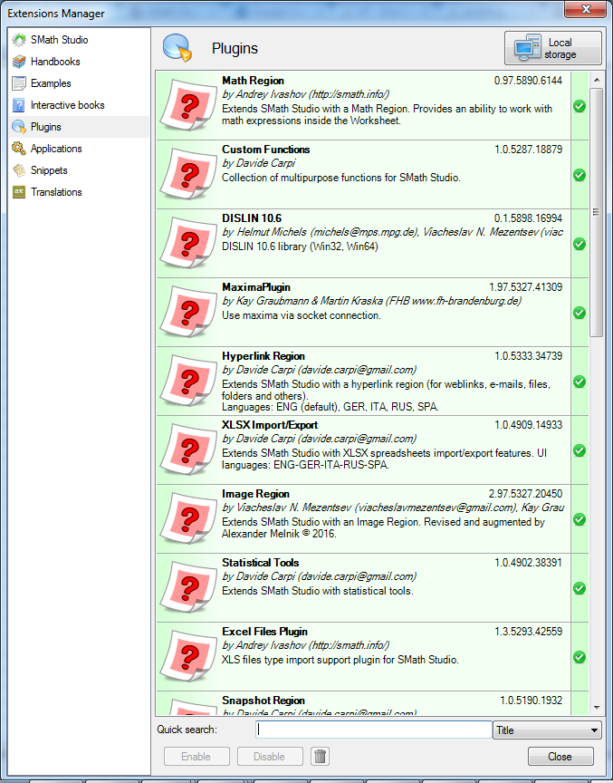

#10 Posted: 2/24/2016 1:58:44 PM
DISLIN 0.1.5898.14938 ?
#11 Posted: 2/24/2016 2:08:58 PM
This is because of other program settings. I'll fix it now.
#12 Posted: 2/24/2016 2:26:37 PM
Updated. Try now.

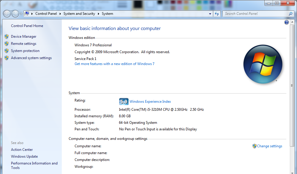

#14 Posted: 2/24/2016 4:53:36 PM
Strange on my system Smath crashes and I am forced to close the program.
The release installed is
Working under Windows 7 Professional
Franco
Franco
