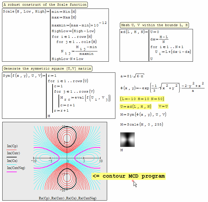

something else of much different nature. Contour plots ends being
an XY plot. I have a Mathcad contour program [done by Collab].
Just scared to attempt Coding in Smath. Some of you gurus, I can
make an image of the program for your bed time reading.

... that's what I meant about a comprehensive "DISLIN start".
Contour is for exporting specific contour data. The feed is a
matrix, either well populated or splined and you get what you
want. Collapse the function, plug the matrix from source or
from function ... ready for the contour(s), just few clicks.
I lost patience trying to imitate Mathcad "on error".
So, attempting the program is not tempting.
The program images included in the *.sm work sheet.
Contour Electron.sm (239,09 КиБ) скачан 2170 раз(а).

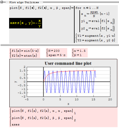

... native SS 6179 ... sorry but I have no interest *.svg
Stand alone user command line is more my cup of tea.

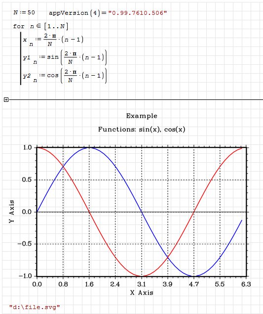

#47 Опубликовано: 05.11.2020 12:34:36
EULA
Updated.
Changes:
- updated to DISLIN 11.3.3 (799 functions);
- refactored.
Цитата
Grant of Free Usage
You are allowed to use DISLIN for free. Either as a private person or in a
commercial or non-commercial environment. There are no limitations.
Click to enlarge
DISLIN. Example 1.sm (95,34 КиБ) скачан 2198 раз(а).
DISLIN. Example 1.pdf (287,2 КиБ) скачан 1516 раз(а).
