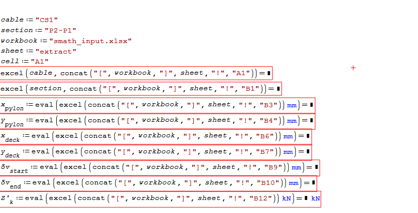

the last time, my smath file still works. But now, the calculation cannot run. maybe the syntax is changed. image.png
sorry, it solved after login
