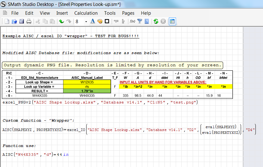

excel_PNG - exports excel range to PNG file (together with row/column headers, formatting, charts, etc.) - can be used together with Image region.
Function excel_PNG() was modified to take 5th argument – the font size of excel range table headers (set to 0 if none). The PNG export speed was increased to about 0.08sec per screenshot. Functions excel_PNGv0 and excel_PNGv2 are obsolete, however kept for the sake of backward compatibility

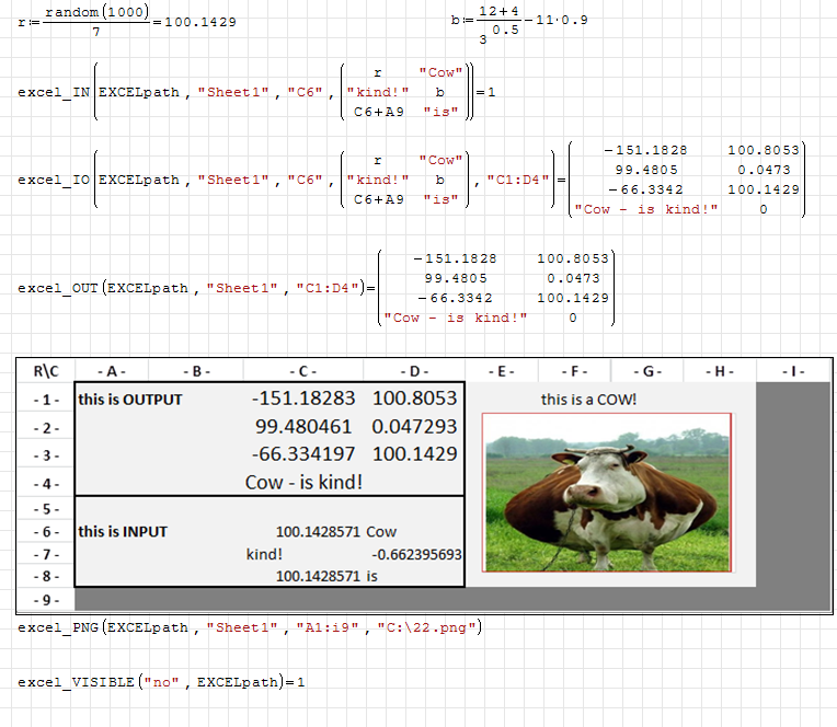

One of the ways to use plugin:
1. Insert image region into SMath workbook for visual confirmation of SMath <-> EXCEL interaction. Use excel_PNGv2 as an argument of the image region, point it to the range you would like to modify in your xls file. NOW YOUR EXCEL WORKBOOK IS OPEN IN BACKGROUND (this step is optional, however handy to visualize your input)
2. Once you visually see the screenshot of your excel file (together with row/column headers) you can use excel_IN to modify particular cells of the file.
3. Insert image region into SMath workbook that refers to your desired output range in xls file (similar to 1, this step is optional, however handy to visualize your output)
4. Use excel_OUT to point to particular cells/ranges in xls file (once you visually identify them from image region).

AISC Shape Lookup.xlsx (3.27 MiB) downloaded 1922 time(s).
SampleHowTo.zip (1.29 MiB) downloaded 1192 time(s).
Steel Properties Look-up.sm (25.09 KiB) downloaded 2175 time(s).

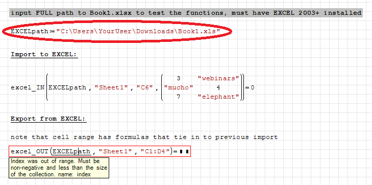

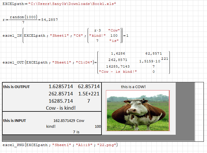

And... There is an error. Screenshot is attached.

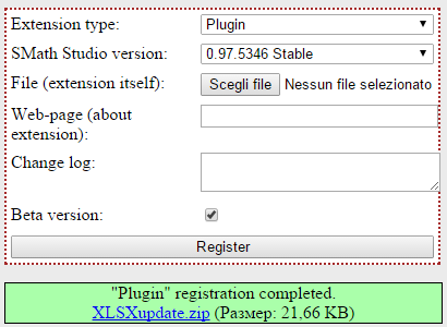

Tried today with Excel 2010, i get an "index out of range" exception with excel_OUT and excel_IO (no issues with excel_PNG and excel_IN)

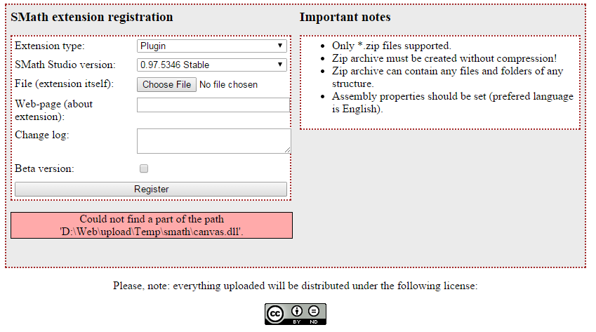

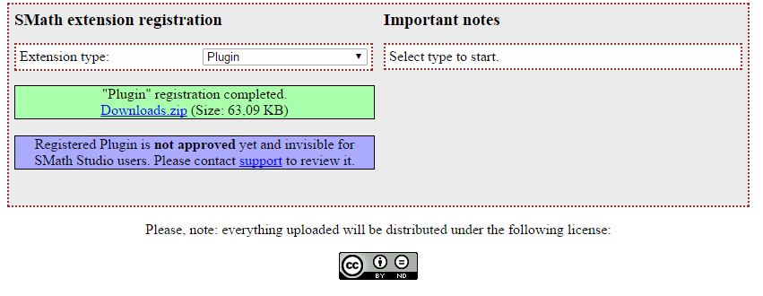

About the registration of the plugin, I've tried and I haven't noticed issues (used just the dll in an uncompresed archive)

Could you please confirm that "index out of range" error is due to file not being specified correctly? Circled is generic path that needs to be changed. I will update the plugin so correct exception is shown.
Will try uploading myself again. Did you include in archive only two plugin files .dll and .pdb?
Thanks!
Thanks!
Just the dll. Including the PDB however should not change anything.

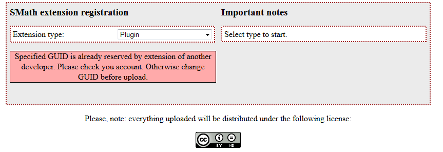

Davide, could you please remove your version of my plugin, i get following error:

Plugin and folder was deleted immediatly after the upload, you have to ask Andrey to access manually the database
Andrey Ivashov 4/17/2015 8:52:00 PM
#14 Posted: 4/17/2015 8:51:55 PM
2,343 likes in 4,056 posts.
All references to uploaded by Davide extension removed. Please try to register extension again by yourself.

I have successfully uploaded my plugin to extension manager.
Davide, Andrey - thank you for your help!
P.S.: Andrey, I believe you will need to review / approve it.
Approved OK with one comment: please don't include auto generated *.pdb and *.xml files into plug-in package next time.
Thank you!

Update to a plugin - exported PNG includes row and column headings. I find it particularly convenient because one can visually refer to a desired excel cell/range after taking a glance at the spreadsheet screenshot.
