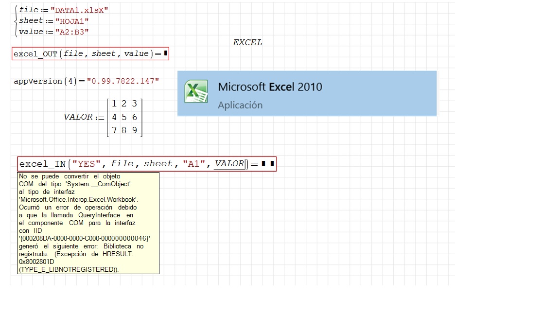

Greetings to all, thank you very much for this opportunity to be here in this forum,
I have tried to solve this problem, thank you very much for your comments and success to all.

Ricardo, at first, I would say the issue is the "x" in ".xlsx" being in uppercase,
but I can't make this plugin nor Clipboad Region work after the last update,
so maybe the real plugin are within the plugins themselves.

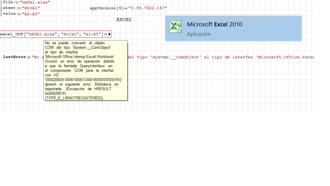

ERROR-OUT EXCEL.jpgMuchas Gracias por su respuesta, Eng. João Felipe Melo es una sorpresa la respuesta de su persona.
Sigo y veo los videos en su canal YouTube. Mil gracias nuevamente.
Éxitos siempre.
Thank you very much for your response, your response is a surprise.
I follow and watch the videos on your YouTube channel. Thank you again.
Successes always
Muito obrigado pela sua resposta, sua resposta é uma surpresa.
Eu sigo e assisto os vídeos em seu canal no YouTube. Obrigado novamente.
Sucessos sempre.
Rikardo21
#98 Posted: 9/20/2021 12:53:08 PM
600 likes in 1,381 posts.
I couldn't make the plugin work either.
Meanwhile you can install DataExchange plugin.
There is exportData.XLSX() in it.
That function maybe can help you.
#99 Posted: 9/20/2021 1:15:24 PM
Ricardo_Herrera
Ricardo_Herrera
1 likes in 8 posts.
overlord: Thank you very much for your reply.
The plugin does work.
use "DataExchange plugin",
question:
some replacement for the "Excel_PNG()" plugins
Thank you very much for your support. to all.
Rikardo21
#100 Posted: 9/20/2021 1:31:24 PM
1,558 likes in 1,868 posts.
I have not been able to reproduce this problem in my environment. Could you please attach the contents of the XLSXupdate.log file that appears when the program starts?
The path is: %appdata%\SMath\extensions\plugins\e40eaef6-4622-4ef3-ad03-077e8f005bb1\x.x.x.x\ (x.x.x.x - the plugin version)
