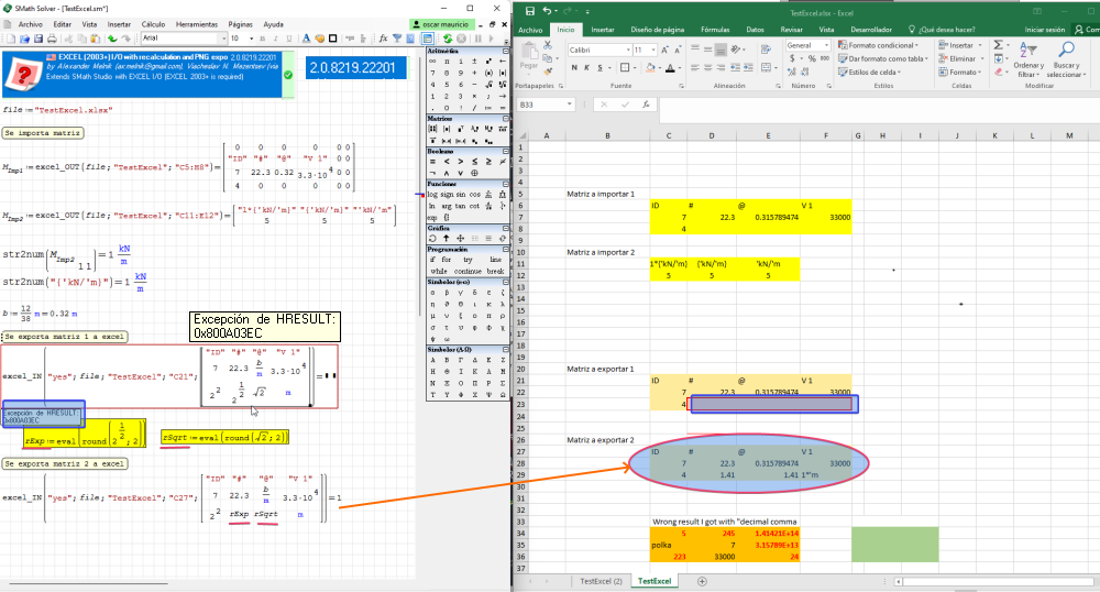

Hello, good morning, could I send a screenshot to see the error that generates a hug from a distance
Rikardo21

Hi, I have the same problem as Ricardo, any recommendations to solve it?
Show Spoiler

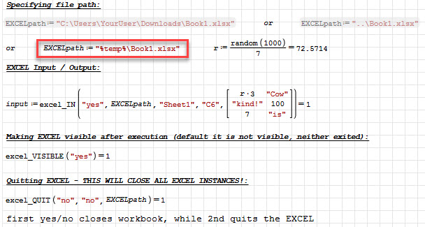

You can use operating system environment variables in the file path.

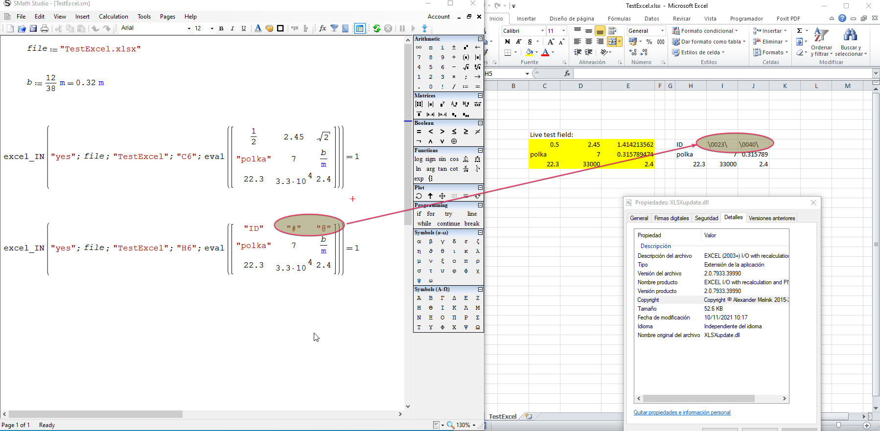

Hello thanks for the plugin, I found a problem in the excel_In() command. I present it in the image, I hope it can be resolved in future versions.
#116 Posted: 7/8/2022 4:45:19 AM
1,558 likes in 1,868 posts.
SMath Studio compatibility
Plugin updated. Please try.
Changes:
- ToCell(): Globals.Excel.DecimalSeparator replaced by the CultureInfo.GetCultureInfo( "en-EN" ).NumberFormat.NumberDecimalSeparator;
- ToCell(): Double.Parse() fixed;
- part of the book "Excel 2002 VBA Programmer's Reference" added (Chapter 22. International Issues).

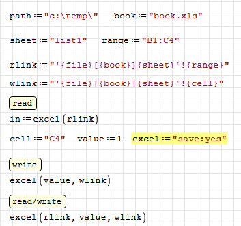

It is possible to simplify the interface. I can add a new feature. You can suggest your own version for a new feature.
#118 Posted: 7/9/2022 6:43:56 AM
In a future release I will remove functions from ExcelIOCom to XLSXupdate. One function and one operand will be added.

#119 Posted: 7/9/2022 12:41:31 PM
SMath Studio compatibility Examples
Changes:
- excel operand and excel() function added;
- readCell() and writeCell() moved from the ExcelIOCom plugin;
- examples added;
- refactored.
