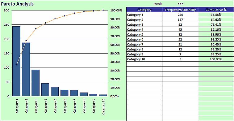

... this one has been sharpened twice.
#62 Posted: 6/16/2016 10:23:25 AM
... what I understand in there: you have the Pareto software, you made the chart,
and transited to Excel to further paste back to Smath. Wouldn't it be simpler to
capture directly from Pareto, resize/resample, reduce 256 colors and paste in Smath ?
#63 Posted: 6/16/2016 10:32:40 AM
Alexander O. Melnik
Alexander O. Melnik
127 likes in 498 posts.
Jean, in my work I would like to avoid manual copy paste of data where possible to eliminate human error. Also it is often that I need to update 20 excel screenshots in a .SM workbook.. This plugin together with image region does it all by itself every time the workbook is evaluated.
Take for example charts. Excel formatting is miles beyond what Smath can do. Use excel_IN to feed the data, excel_PNG to dynamically display the chart.
What do you use for sharpening tool? Looks neat.
Thanks
P.S.: I know that my fascination with excel is arguable. I am all about using best tool for the task; however, often I am strongly encouraged to use spreadsheets, or as it is with graphs, excel just does a better job than Smath.
#64 Posted: 6/16/2016 1:20:34 PM
Thanks
================ I understand [my own way] all what you are doing ==============
I was Excel mad up to WIN Millenium. The switch to Mathcad 8 then 11 replaced my Excel
work because more oriented to solving maths. Since 2000, I have never opened Excel again.
My two most precious tools, companions of Smath are: WinGrab & IrfanView.
Same tools that I got mid 90. If an image is not compatible for pasting in WinGrab,
I transit to Paint, then paste in WinGrab for color reduction [256]. WinGrag will also capture image from web and from any screen display.
Often, images from *.PDF, web ... are poor quality [not sharp].
Then paste in IrfanView and use the "Sharpen" once or multiple times.
From the same IrfanView menu, you can "resize/resample" at whatever %
by respecting aspect ratio. Same quality than PhotoShop for 0$.
Naturally, if an image is to destroyed by JPEG, zoom[+] is poor.
You are right: Smath is more maths oriented than Graphs, thus combine + Excel.

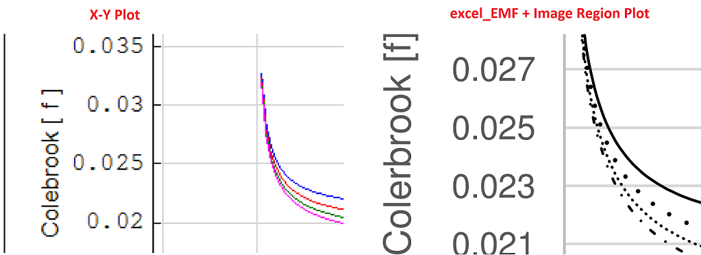

#70 Posted: 10/10/2016 4:31:31 PM
Alexander O. Melnik
Alexander O. Melnik
A sample of a Plot produced by combination of excel_EMF function and Image Region inside the SMath workbook.
The example was borrowed from one of the calculations by Jean Giraud.
Note the difference of as-printed quality between X-Y Plot output and excel_EMF output.
File not found.File not found.File not found.
#71 Posted: 10/11/2016 12:09:50 PM
Thanks Alex,
My Excel 2003 opens your Excel sheet, but somethig(s) it does not like.
It must convert and the plots aren't managable, it's OK. I understand
your plug-in for those that don't work maths, also good for papers.
How did you get such a huge 7.75 MB image !
All the snippets I attach are captured from my 20 years old "WinGrab"
still freeware. After capture, select the portion then reduce colors
to 256 . Generally, WinGrab reduce 256 colors is better than my old
IrfanView. This snippet is 430 KB.
Smath is very convenient for working from files that are created from
the hard maths. As you can see: past the Moody creation, we just have
interest in retrieving any Colebrook 'f' [friction factor]. There is a
way to retrieve from specified Reynolds. It requires a module to search
through data table.
Cheers, Jean
#72 Posted: 10/11/2016 12:28:58 PM
Alexander O. Melnik
Alexander O. Melnik
Jean,
There are two ways to display EXCEL plots / ranges:
1. excel_PNG - produces LARGE bitmap files that print well at 300+ DPI
2. excel_EMF - produces a clipboard of a metafile (native .net vector graphics) which results in a vector graphics PDF prints.
I like using excel_EMF - it produces best as-printed quality plots and is much faster than excel_PNG
Also I saw that you were spooling "Moody" function output to file to speed up processing. No need for that - just define Moody:=eval(your_code) so the function is not executed every time you call it in a SMath worksheet.
