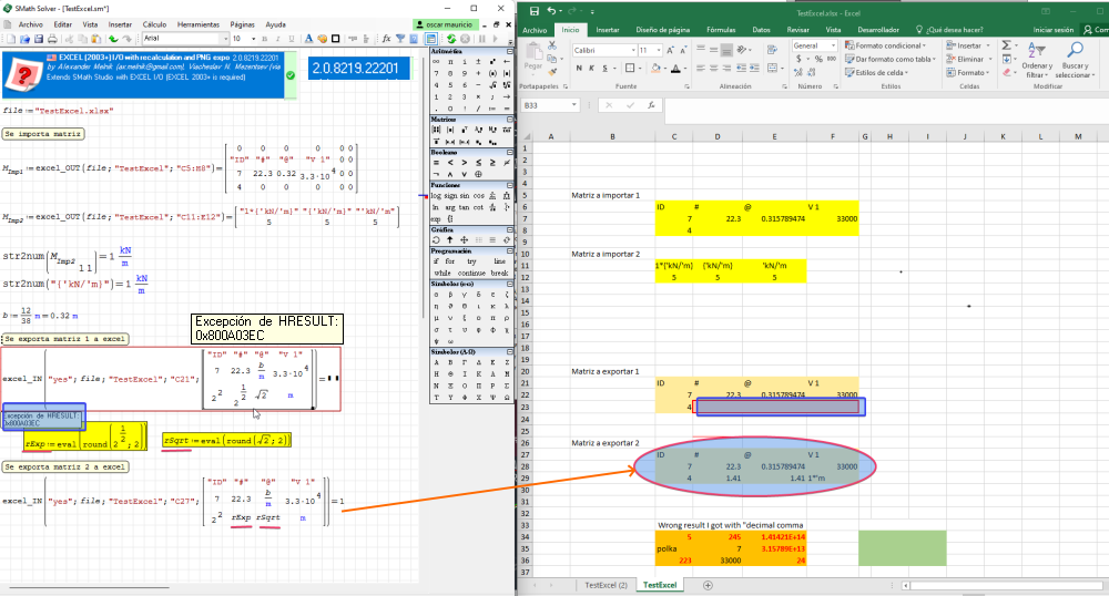

This problem appears due to the presence of old keys in the registry, which will contain the wrong path to Excel. Try to search in Google for a solution to your problem using the error text from the log file:
Excel HRESULT: 0x8002801D (TYPE_E_LIBNOTREGISTERED)

Ricardo, I updated the plugin and made a Quick Repair in my Office 365, restarted the pc and now it works perfectly.
The issue is some bug in Office register.

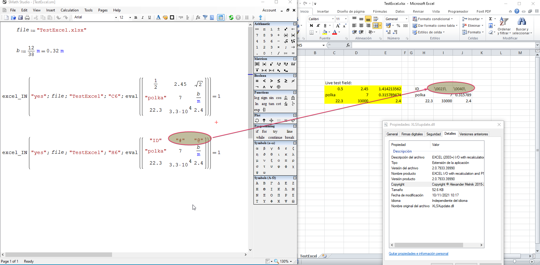

Hi! I'm having trouble sending String variables to Excel.
For instance, ". - / ! ? ;" turns into \002E\\0020\\002D\\0020\\002F\\0020\\0021\\0020\\003F\\0020\\003B\ in Excel.
I'm using most recent SMath and Excel I/O versions.

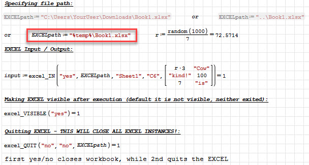

#114 Опубликовано: 03.07.2022 06:10:06
You can use operating system environment variables in the file path.

Hello thanks for the plugin, I found a problem in the excel_In() command. I present it in the image, I hope it can be resolved in future versions.
SMath Studio compatibility
Plugin updated. Please try.
Changes:
- ToCell(): Globals.Excel.DecimalSeparator replaced by the CultureInfo.GetCultureInfo( "en-EN" ).NumberFormat.NumberDecimalSeparator;
- ToCell(): Double.Parse() fixed;
- part of the book "Excel 2002 VBA Programmer's Reference" added (Chapter 22. International Issues).

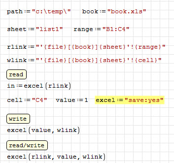

#120 Опубликовано: 12.07.2022 03:40:45
There are several ways to work with Excel documents. I can add support for ClosedXML and EPPlus. In this case I will rename the plugin to Excel Toolbox. The choice of how to work with Excel can be done using a variable:
excel:="driver:COM" or excel:="driver:EPPlus" or excel:="driver:ClosedXML"
Each of the drivers provides its own capabilities. It is possible to try to implement other features, such as:
- create books, add and delete sheets;
- accessing named ranges;
I could change the language used in the plugin (VB.NET), but decided to leave it as an example of development in this language. This introduces some problems, but they are solvable.
