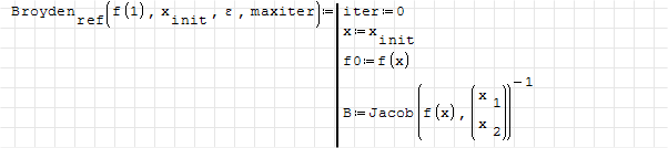

Currently, the plugin follows almost exactly that function, but if anyone has a more efficient version of the algorithm could certainly be implemented.![]()
I've just read that this implementation is better for large problems (see pag 133 of this pdf)
and this is its matlab code

Thank you, is very useful;
i've implemented this script in a Smath sheet and it's more readable, unfortunately the issue related to the first Jacob approximation still remains

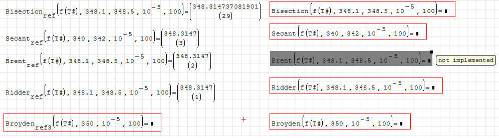

When you have the time, put some examples using Bisection() as well in the next update.

Wrotewow, have you used bisection as an initialization of broyden ?
also i've searched information about the broyden method over time and it seems the most advanced/recent version is a modification of Johnson's by Baran :
http://arxiv.org/abs/0805.4446
As for the Jacob() function, I thought that Broyden didn't use Jacob directly but an approximation..
EDIT:
Never mind, the above paper refers to a gpl program based on other libraries.
There you have the historial of Broyden method,
http://www.unedf.org/content/PackForest2008_talks/Day2/PackForest_JJM.pdf
it seems to me that the "compact" version of 1994 corresponds to the matlab code that I linked above.

Broyden_alpha.sm (75,22 КиБ) скачан 2034 раз(а).
Thanks for your work!!
Edit:
Again since Broyden is not globally convergent, bisection might be interesting as an initial approaching to the roots

This is one of my working problems I was already mentioned Primer 65a and struggled in SMath with. I reported there the problems of solve() and roots() solutions.
I used it again for testing and attached it to this post. It seems the problem is a bit numerically "tricky" for solving in SMath. The original file is not working in the recent SMath version, neither solve() nor roots() (error message about T as undefined variable - not quite sure why). Here I attached the revised file - just removed eval() I was talking about in the previous post. Fortunately, solve() will now get the more accepted result
Regarding this problem, I am satisfied that at least one of the possible tool in SMath can give the result.
Primer65aa.sm (41,67 КиБ) скачан 2081 раз(а).
Without insight into the nature of the problem, root finding is more or less blind search, this is why I suggested a multidimensional bisection method for a initial guess with just a few iterations.
With some insight into the nature of the root, Newton’s method using derivative information, and Broyden’s method using only function information seem good candidates.

WroteHello,
I used it again for testing and attached it to this post. It seems the problem is a bit numerically "tricky" for solving in SMath. The original file is not working in the recent SMath version, neither solve() nor roots() (error message about T as undefined variable - not quite sure why). Here I attached the revised file - just removed eval() I was talking about in the previous post. Fortunately, solve() will now get the more accepted result, roots() will fail, Broyden() will give the answer if the guess value is quite close to the solution, Bisection() will fail as well. I hope I did not make any serious mistake here.
I omorr, i'll check this issue ASAP, especially because in this case the script seems to work while the plugin don't work...
