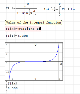

For sure very interesting but incorrect from the onset.
"splines" are not functions, just zombie interpolation.
You can't plug "zombie" in in a vector for ODEsolve or rk solve.
"simply deceiving because deceivingly simple"
Cheers, Jean
Forum Radovan Integral.sm (209.45 KiB) downloaded 1640 time(s).
Cheers, Jean

You are right Radovan,
Smath splines [ainterp, cinterp, linterp] are "canvas" plotting
and on-line evaluation. They don't create a function thus can't be
use to integrate directly. You have two alternatives:
1. Dicretise/integrate finites differences
2. Transit via Infinitesimal modules
I went as far as I could in the attached. Plotting the components.
The "solve" block fails miserably, why?
It attempts to retrieve back to the integral that Smath does not
produce. The "solve" does not interpret the integral transit because
the solve block is a foreign entity. The Mathcad find(x) looks incorrect.
It depends upon initialisation. In this case the worng checks right.
Though the Mathcad Given/Find is often robust, it failed 1000's times
in my 15 years Mathacd collab.
Mathcad plots your integral, smath does not, thus it reflects in the "solve".
Please don't hesitate to correct me if I can help more.
Cheers, Jean
Forum Radovan Integral.sm (192.6 KiB) downloaded 1834 time(s).

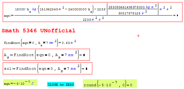

#205 Posted: 10/25/2016 2:43:38 AM
#206 Posted: 10/25/2016 10:07:02 AM
WroteWhy is this working for me and not for you - I do not know.
Simple: the solve block of your version is more robust
or the chained code less reactive ? The other curiosity
5346 official release ..... 120 sec
5346 UNofficial release.... 14 sec
I got used to solve failure, rescue dichotomy.
BTW: eval(,) is not needed for f1(x)[faster].
Thanks Radovan, your collaboration is most appreciated.

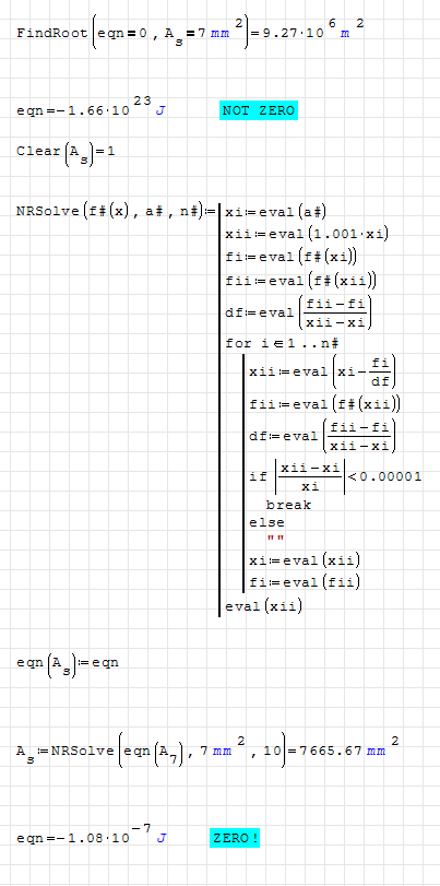

Davide,
Here is an unforunate example of FindRoot() being unable to solve a problems with units... While my very quick NR Line() solver works just fine.
I wonder if we run into max + number problem or devision by zero.
Hoping for a fix!
FindRootBug.sm (11.93 KiB) downloaded 1647 time(s).
Hoping for a fix!

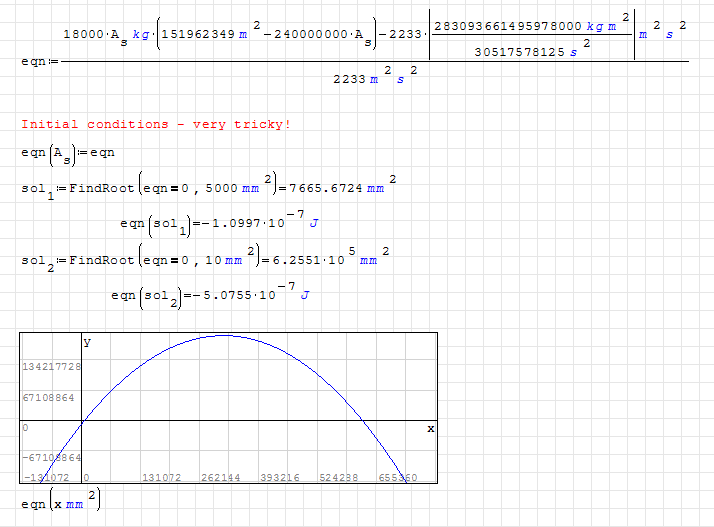

#211 Posted: 10/27/2016 11:10:42 AM
Actually, it could be done - but setting the initial conditions for FindRoot() could be very troublesome for this example.
Initial conditions are chosen just on trial and error, and the calculation can diverge easily by slight changing of IC.
This is basically a second order polynomial having two solutions.
FindRootBug-corr.sm (16.62 KiB) downloaded 1623 time(s).

#213 Posted: 10/27/2016 12:12:28 PM
WroteActually, it could be done - but setting the initial conditions for FindRoot() could be very troublesome for this example.
Is there a reason why solver would gravitate to wards a solution further from initial guess? If it were just to follow the slope at the initial guess value it would arrive to the closer, and in my case correct, solution
So far in my expirience it is almost always possible to make FindRoot() solve by substituting just the right value. There has to be a reaon why the function tends to overshoot nearest solution by so much. Also when it does not find a desired solution, the number it spits out is not always a mathematical solution either

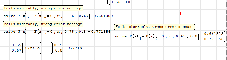

#217 Posted: 10/28/2016 8:17:19 PM
Thanks Davide: I fell in love with SIG !
Yes Radovan: a "Peak/Deep/Root" in the menu would be great,
c/w different options. As robust they will look at the design
stage, they will not be so. Read again "ULP".
Going back to "FindRoot": as it looks in similar applications,
it is same or so Mathcad, a very universal code. For the free
finding solutions, IC must be either 0 or 1 [1 to releive from
"divide by zero"]. In examples [1,2] notice the switch of the
solutions. Be careful as it may scrap the project !
Examples [2, 3], Quaternion and Frobenius are robust and correct.
I didn't completely understand Alex example/problem. A case of
constrained IC difficult to handle and prone to fail.
Cheers, Jean
Solve Given_Find [UN test Robutness].sm (31.18 KiB) downloaded 1536 time(s).
Solve NON-Iterative SIG.sm (44.25 KiB) downloaded 1665 time(s).
Cheers, Jean

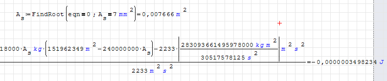

#218 Posted: 10/29/2016 11:37:11 AM

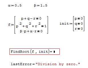

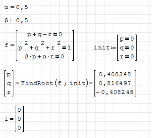

Just for the record (especially for Davide) FindRooot() just does not work in the recent SMath for few of your examples with the error like in the picture. Actaually, it does work when you change the IC from zero to some other values.
Davide Carpi 10/29/2016 12:28:00 PM
#220 Posted: 10/29/2016 2:14:57 PM
That's not a bug Radovan:
=>...For the free finding solutions, IC must be either 0 or 1
[1 to releive from "divide by zero"]<= ... {previous message}
Maybe you are not up to date vs Davide ?
