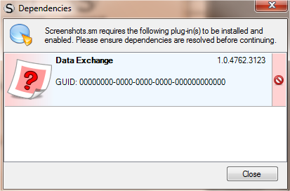

#115 Posted: 6/10/2013 3:41:09 AM
1,443 likes in 2,935 posts.
PLUGIN UPDATED
- XLSX features moved away (see Xlsx Import/Export plugin )
- plugin added to the Gallery (Latest Nigthly build)
- Added Guid (after installing the plugin, a message should appear opening old files, just skip it and save again the file)
best regards,
Davide
4 users liked this post

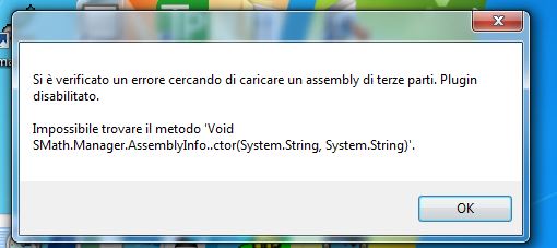

when the program starts, the following message appears
operating system Win 7
smath versione 096 4868
net framework 4.5.1
#118 Posted: 12/30/2013 9:47:42 AM
Hi Paolo,
I can't reproduce your issue (win7 x64 - SMath 0.96.4909)
Are you sure that this plugin cause the issue? copy and paste the red string ( %APPDATA%\smath\extensions\plugins ) in your windows start menu, press the return key and then delete the plugin folder (5dce7298-9e5f-4120-9a2e-49b16daa02a3) then try to start SMath again.
Davide
#119 Posted: 12/30/2013 3:11:25 PM
paolo1963
paolo1963
1 likes in 4 posts.
I uninstalled the version of SMath 096 4868 and I installed version 096 4909 now the program starts.
Save in *. odt work,
while saving in *. tex from the following error message:
