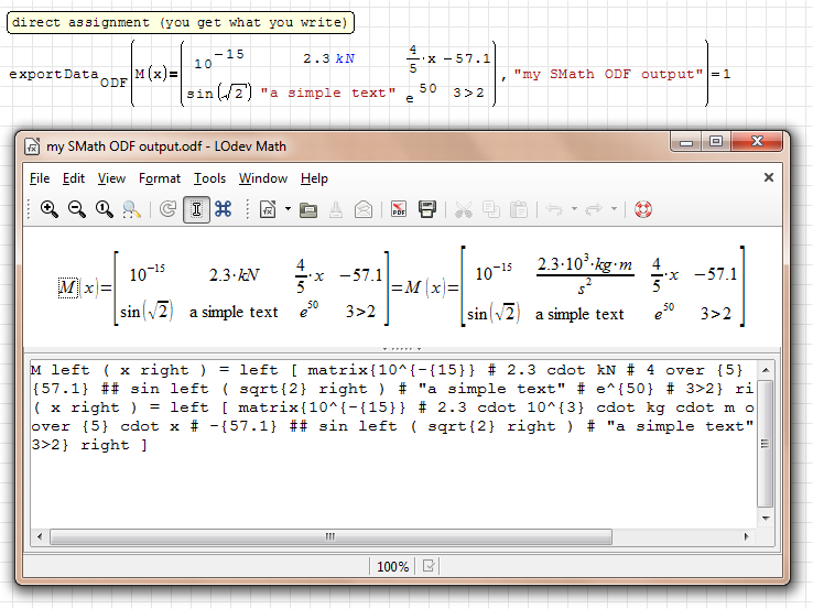

PLUGIN UPDATED
added [MATH lang=eng]exportData.ODF[/MATH] to export data to OpenFormula files.
[edit] when possible, the default output is: formula as defined = symbolical formula (variables replaced with numbers) = numerical output value
direct assignment: data to export written inside [MATH lang=eng]exportData.ODF[/MATH] 1st argument.

Hello w3bsurf3r,
thank you for the math export function. It made me download and install OpenOffice (I normally use LyX/Latex or MS Office).
I would propose to stick to standard notation in export functions, which would mean:
  • quantity symbols are typeset in italic (this is currently done correctly)
  • unit symbols are typeset in roman (by adding "nitalic" or marking as text by quotation marks)
  • Number and unit are separated by a (small) space (replacing cdot by ` in front of units)
Perhaps a context menu option to copy the region to clipboard in odf or latex notation could be a nice feature. But of course, I have no idea if and with what effort this can be done.
Martin

Hi Martin,
I think it's a good standardization, I'll do it in the next relase

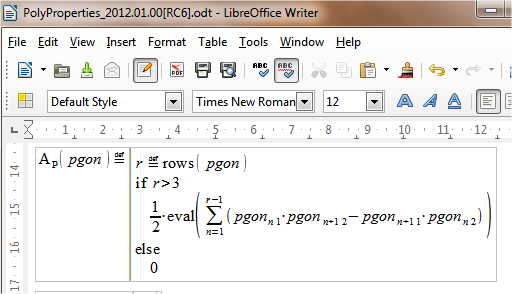

PLUGIN UPDATED
REQUIREMENTS: .NET Framework required version upgraded to 3.5
  • added "Save as" odt files:
    - editable equations;
    - text formatting like SMath worksheet (size, colors, style:bold/italic/underline);
    - page size & orientation like SMath worksheet.
  • added [MATH lang=eng]exportData.XLSX[/MATH] and [MATH lang=eng]importData.XLSX[/MATH]
  • ODF formulas:
    - added: el(3), range(2), range(3), sys(), all trigonometric functions, subscripts, absolute variables (~variable), empty values (#), nested quotes.
    - units: typeset, multiplication symbol;
    - text: added quotes, alignments inside matrices;
    - programming: added line()*, if/else, for(3), for(4), while();
    - booleans: fixed comparision symbols issues;
    - general: fixed conflicts with reserved words and symbols, output markup adjustements.
  • dynamic assistance adapted to multilanguage (ENG/ITA implemented, send me a PM with your translations to have more languages)
  • [MATH lang=eng]exportData.CSV[/MATH] and [MATH lang=eng]exportData.ODS[/MATH] enhanced to export even unassigned variables.
* when there is a variable/function defined with a line(), the right side could be higher than the left side; simply add some #{} after the = sign to pull up the left side.

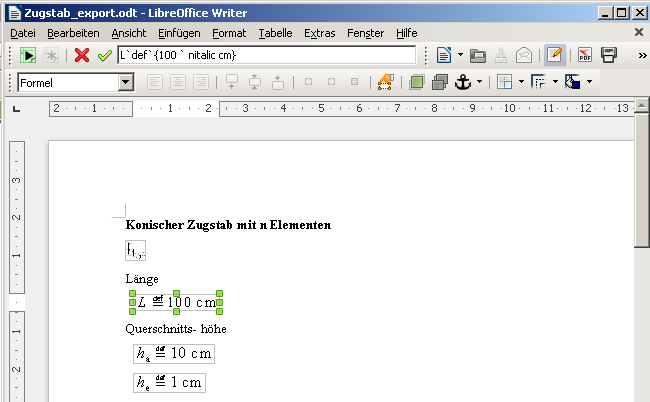

#37 Posted: 1/18/2013 8:45:09 PM
1,361 likes in 2,275 posts.
Hello w3bsurf3r,
I tried with LibreOffice 3.6
Here are the example files for the image size problem
Zugstab_export.odt is as exported by SMath,
Zugstab_export_LO.odt is as saved by LibreOffice Writer.
I had to zip the files because odt attachments are not allowed in the forum.
Martin

Try the attached DataExchange.dll
DataExchange.zip (25.68 KiB) downloaded 586 time(s).
images now have the correct size, thank you for the bug fix. Also, direct word read in is possible (zugstab-export-1.odt). However, in this case only images and text regions are read, all math regions (formulas) are broken.
Intermediate load and save with libreoffice (zugstab-export-LO-1.odt) improves the word import, still the formatting of control structures is broken.
