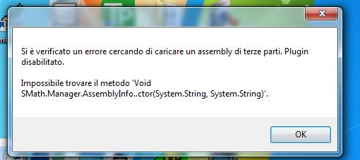

when the program starts, the following message appears
operating system Win 7
smath versione 096 4868
net framework 4.5.1
#118 Опубликовано: 30.12.2013 09:47:42
Hi Paolo,
I can't reproduce your issue (win7 x64 - SMath 0.96.4909)
Are you sure that this plugin cause the issue? copy and paste the red string ( %APPDATA%\smath\extensions\plugins ) in your windows start menu, press the return key and then delete the plugin folder (5dce7298-9e5f-4120-9a2e-49b16daa02a3) then try to start SMath again.
Davide

#119 Опубликовано: 30.12.2013 15:11:25
paolo1963
paolo1963
1 сообщений из 4 понравились пользователям.

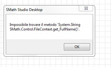

I uninstalled the version of SMath 096 4868 and I installed version 096 4909 now the program starts.
Save in *. odt work,
while saving in *. tex from the following error message:

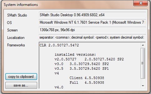

#120 Опубликовано: 03.01.2014 20:56:45
Really strange, I can't reproduce this issue
The problem is related to some worksheet (empty file, with figures, with text, with math), some machine, or is general?
Have you the same issues with the unofficial portable version?
You could try to share here your system informations (Development Tools plugin > System informations > save as... > attach here the file)
