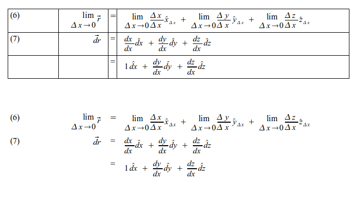

hi DC,
save as ODT's amazing plugin
more work needed to get document look likes a textbook
UserPostedImage
i usually using repetitive tedious works, add manually ""phantom{...} to hiding, so document become readable and not making eyes victim
just wondering, is this possible to do automatically formating by default? since OOo/LO hard and maybe can not access find and replace for embeded formula
thx u s much

Hi xyonx,
I think it's possible, I'll try to see what can be done
IMHO your multiline approach it's a very interesting way to represents results and could be an useful solution for Andrey to implement the "Display values with definition" request of SMath users.

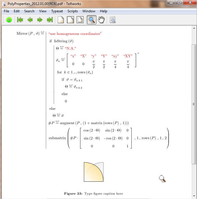

PLUGIN UPDATED
  • added "Save as... > LaTeX Text Document";
  • ODT saving:
    - ouptut ODTs now are compatible with MS word (brackets looks better than saving the file from libreoffice)
    - added options on ODT saving (Save text as images/Save formulas as images/evaluate equations)
    - "Print Area Regions" settings from "Page Setup..."
    - SMath texts on multiple lines now are shown on multiple lines even in the output file.
    - minor changes
  • ODF saving: each evaluation (input formula/symbolic/numeric) written on a different line of code;
  • Embedded languages: ENGLISH/ITALIAN/RUSSIAN

Hello w3bsurf3r,
thanks for updating the plugin. The Latex-export looks great (not yet tested, but your preview looks promising).

after a closer look to the latex export I recommend the following:
- left align the equations using \usepackage[fleqn]{amsmath}
- typeset the break and continue statements in roman (mathrm)
- remove all empty lines (less space between equations)
- provide choices (if possible with adjustable default settings) for
- assignment operator (:= vs def over =)
- equation numbering (starred or unstarred equation environment)
Martin
-- assignment operator (:= vs def over =)
-- equation numbering (starred or unstarred equation environment)
- left align the equations using \usepackage[fleqn]{amsmath} -> done
- typeset the break and continue statements in roman (mathrm) -> fixed (LaTeX/StarMath/MathML) (\operatorname may be better?)
- remove all empty lines (less space between equations) -> mhhh... we don't lose tex file readability from the user?

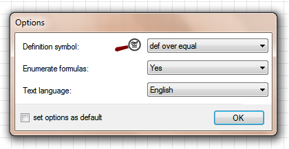

ok... consider that actually you can easily change the define equal of the entire file by editing the header
\newcommand{\defeq}{\stackrel{\text{\tiny def}}{=}} % SMath 'define equal'
I admit that these proposals were just matter of comfort. The trade between user comfort and coding effort is of course your decision.
Perhaps, an alternative could be to have sort of template in some sensible place (somewhere in install dir or in a system user dir). The default then would be what you currently have.
I bet there is no chance to design a single template such that it works in any language environment. In my case, the german umlauts fail to compile, even if I use my input- and fontencoding from the handbook source. Perhaps there is just too much side effects and dependencies between the packages (I never used some of the ones in the latex export).
[DONE] (can memorize settings)
