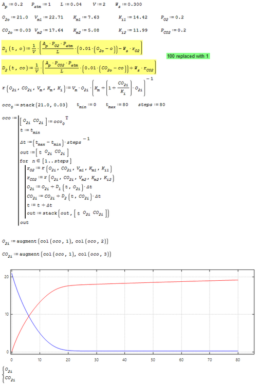

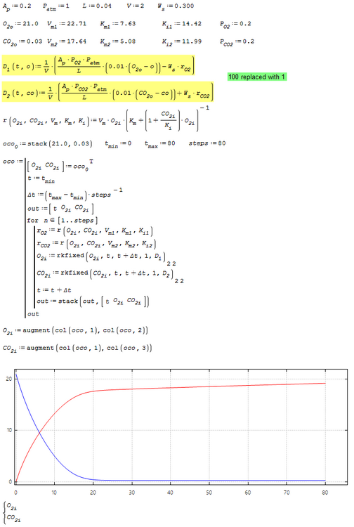

#39 Posted: 11/30/2020 3:39:42 AM
1,558 likes in 1,868 posts.
It is possible to solve the system in this way, i.e. integrating each equation separately. But here you need to be very careful.
