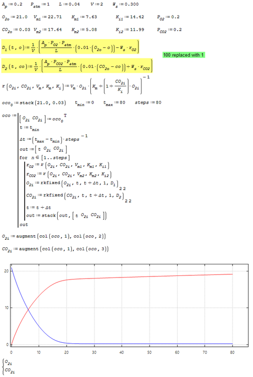

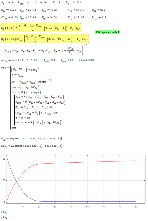

Now, sorry for bothering you again, I would like to have another little help.
To have the model properly working I need to add some other pieces, and I made some tentative to put these pieces is with some uhmmm "horrible" results.
Now, If you can give me feedback on what I have done on pages 2-3 would be lovely
I would like to understand if what I have done is totally wrong or if there are some "grammatical" errors.
So any Help is welcome!
Modeling respiration-transpiration FRA2.sm (46,51 КиБ) скачан 1104 раз(а).

1. Forget AbsTol, RelTol ... there is no known use, specific to dn_GearsBDF
2. mr.pr not defined
3. Construct the DE piece wise
What you have is so far not same as the previous work
The original *.PDF is so much jargon ... their DE is what you should use.
I can't follow your D(t,oco).
Prova modello permeabilita.sm (158,5 КиБ) скачан 1108 раз(а).
Thank's a lot for all the observations!
I thought to had to define m.pr in the stack XD my bad
Now I try to rewrite all in a more clear and comprehensible way, maybe with some comment!
Veniamo da molto lontano e andiamo molto lontano! Palmiro Togliatti

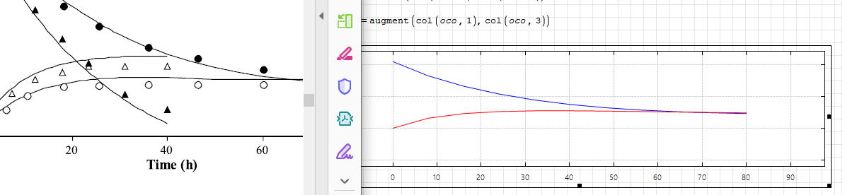

... the DE system from the paper. Originally, you composed two DE.
That paper is damned hard to follow, probably a plagia itself.
Yes, in reality, that two DE was just a first step.
What I need to do is just a little bit more complex than what is written in the first paper, because there are a lot of things that have an influence on the mass transfer in a package.
So, what I'm trying to do is to add a piece at once.
Now, in the last file there are in oco 5 pieces.
[O.2i (oxygen in the package),
C.O2i (CO2 in the package),
m.pr (amount of water that permeate through the plastic film),
W.1 (weight loss of product due to the loss of water),
HR1 (humidity in the package]
Now, unfortunately, all these factors are correlated...and more are needed for describing all the system.
I'm trying to write in a very simple way what I would like to do on the smath file, and I hope it will be possible.
Honest, more I look at the sheet and more it seems a mess to me.
I need to find a way to make it more simple
Presentation1.pdf (107,23 КиБ) скачан 645 раз(а).

#39 Опубликовано: 30.11.2020 03:39:42
It is possible to solve the system in this way, i.e. integrating each equation separately. But here you need to be very careful.
Modeling respiration-transpiration in a modified atmosphere packaging system containing blueberry 2 (uni).pdf (83,13 КиБ) скачан 682 раз(а).
Modeling respiration-transpiration in a modified atmosphere packaging system containing blueberry 2 (uni).sm (18,4 КиБ) скачан 1210 раз(а).
Modeling respiration-transpiration in a modified atmosphere packaging system containing blueberry 2 (uni).png

#40 Опубликовано: 30.11.2020 03:54:05
Euler is still good.
