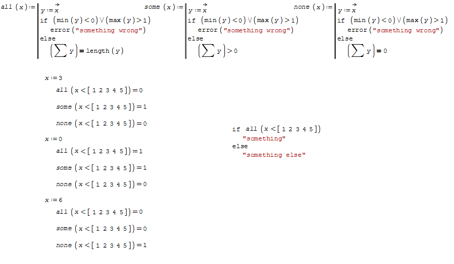

You can always create some function to make it look like you are working with some set of numbers
sergio 2022/5/9 10:55:00, Alvaro 2022/5/9 11:19:00, Arie 2022/5/9 16:16:00
Hi Davide. Great idea. These functions can be very useful for translating matlab programs. They can also be extended to arrays, as the all, any and nnz functions do.
