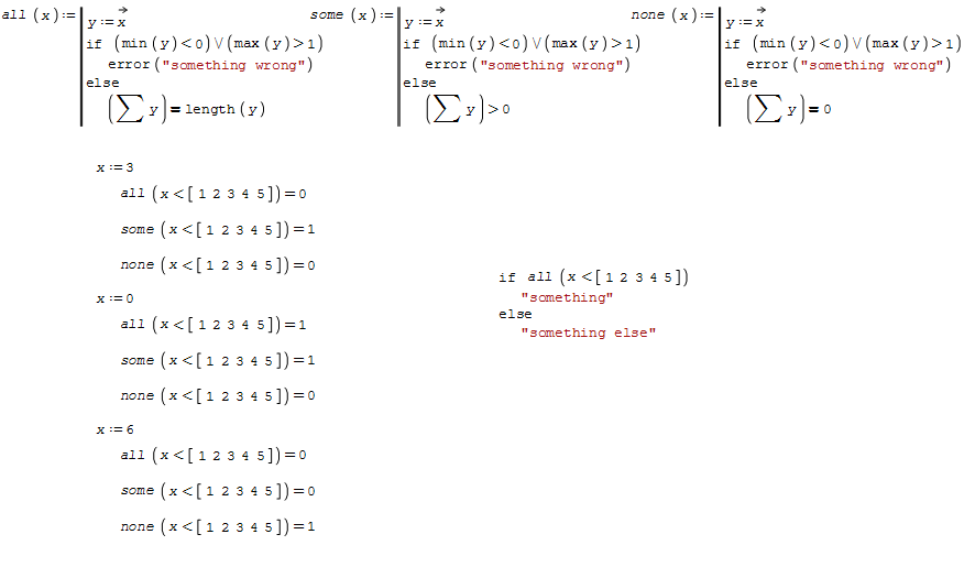

#5 Опубликовано: 09.05.2022 08:37:41
You can always create some function to make it look like you are working with some set of numbers
sergio 09.05.2022 10:55:00, Alvaro 09.05.2022 11:19:00, Arie 09.05.2022 16:16:00
#6 Опубликовано: 09.05.2022 10:06:38
Tanks Davide ... coded/saved.
Take care ... Jean.
Maths Conditional Davide.sm (12,36 КиБ) скачан 1643 раз(а).
sergio 09.05.2022 12:46:00
#7 Опубликовано: 09.05.2022 11:25:27
Hi Davide. Great idea. These functions can be very useful for translating matlab programs. They can also be extended to arrays, as the all, any and nnz functions do.
