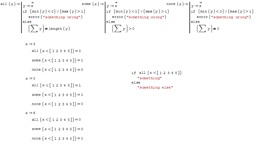

You can always create some function to make it look like you are working with some set of numbers
sergio 5/9/2022 10:55:00 AM, Alvaro 5/9/2022 11:19:00 AM, Arie 5/9/2022 4:16:00 PM
Tanks Davide ... coded/saved.
Take care ... Jean.
Maths Conditional Davide.sm (12.36 KiB) downloaded 1643 time(s).
Hi Davide. Great idea. These functions can be very useful for translating matlab programs. They can also be extended to arrays, as the all, any and nnz functions do.
