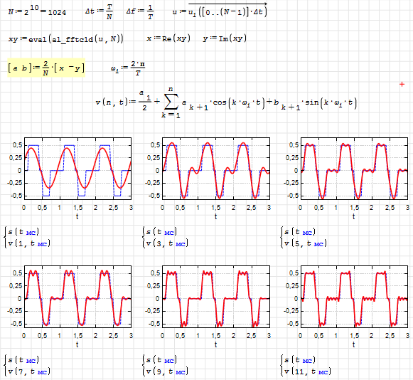

#44 Posted: 2019/1/27 05:23:49
1,554 likes in 1,864 posts.
With numeric optimization (for all functions) it works much faster.
Fourier series coefficients.sm (17.54 KiB) downloaded 1560 time(s).
Fourier series coefficients.pdf (138.41 KiB) downloaded 903 time(s).
4 users liked this post
Radovan Omorjan 2019/1/27 08:19:00, Davide Carpi 2019/1/27 07:53:00, frapuano 2019/1/27 08:21:00, NDTM Amarasekera 2019/1/27 09:47:00

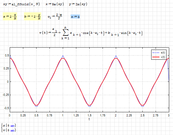

#45 Posted: 2019/1/27 10:59:21
Example 2.
Fourier series coefficients.sm (28.46 KiB) downloaded 1689 time(s).
Fourier series coefficients.pdf (170.26 KiB) downloaded 1037 time(s).

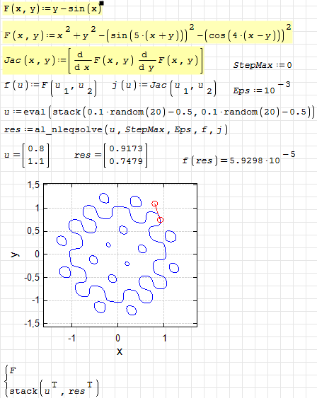

#48 Posted: 2019/2/18 05:42:17
Fridel Selitsky
Fridel Selitsky
520 likes in 451 posts.
Parameterization of implicit functions with al_nleqsolve
Parametrisation.sm (29.88 KiB) downloaded 1604 time(s).
NDTM Amarasekera 2019/2/18 11:46:00, frapuano 2019/2/18 09:08:00, Alvaro 2019/2/18 14:00:00, Вячеслав Мезенцев 2019/2/18 17:50:00
#49 Posted: 2019/2/18 13:59:33
1,123 likes in 1,795 posts.
Hi Ber. Nice technique, easy to implement. You can also make that as a function, and monocolor too.
Parametrisation.sm (25.37 KiB) downloaded 1538 time(s).
Another option could be use y0 as vector, and solve for each element in y0, obtaining res, res1, ..., resn
Fridel Selitsky 2019/2/18 14:44:00
#50 Posted: 2019/2/18 23:53:03
1. SS 6179 does not complain
2. Takes ~ 1 hr to terminate the first function
3. NO plot result [NO complain but NO plot ?]
4. Would be interesting checking if the attached SS 6179
runs in your actual AlgLib 3.1x. If NOT => would be a dramatic bug.
It would indicate that all maths based al_nleqsolve would be scrap.
Contour SOLVE [Electron Solve algo Express].sm (20.66 KiB) downloaded 1341 time(s).
