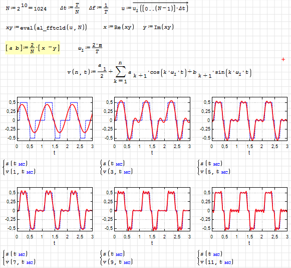

With numeric optimization (for all functions) it works much faster.
Fourier series coefficients.sm (17.54 KiB) downloaded 1664 time(s).
Fourier series coefficients.pdf (138.41 KiB) downloaded 964 time(s).

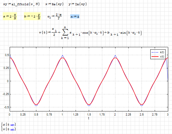

Example 2.
Fourier series coefficients.sm (28.46 KiB) downloaded 1798 time(s).
Fourier series coefficients.pdf (170.26 KiB) downloaded 1116 time(s).

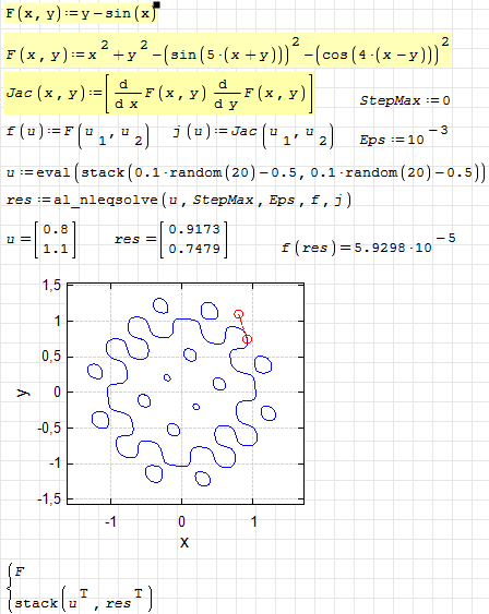

Parameterization of implicit functions with al_nleqsolve
Parametrisation.sm (29.88 KiB) downloaded 1704 time(s).

Hi Ber. Nice technique, easy to implement. You can also make that as a function, and monocolor too.
Parametrisation.sm (25.37 KiB) downloaded 1645 time(s).
Another option could be use y0 as vector, and solve for each element in y0, obtaining res, res1, ..., resn
