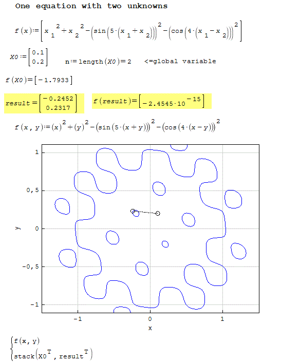

Fortunately, I was wrong. We could use it with different number of equations and unknowns.
I just use the Ber7 example and change it with n as a global variable. No need for zeros as non-existing functions.
Primer%20Uni-mod.sm (13.3 KiB) downloaded 1496 time(s).

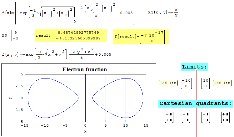

But for some reason simple Newton-Raphson with variable step usually
works better than al_nleqsolve.
#25 Posted: 2018/7/18 15:19:47
Can you demonstrate for this application ?
Solve al_nleqsolve-Electron.sm (18.41 KiB) downloaded 1428 time(s).

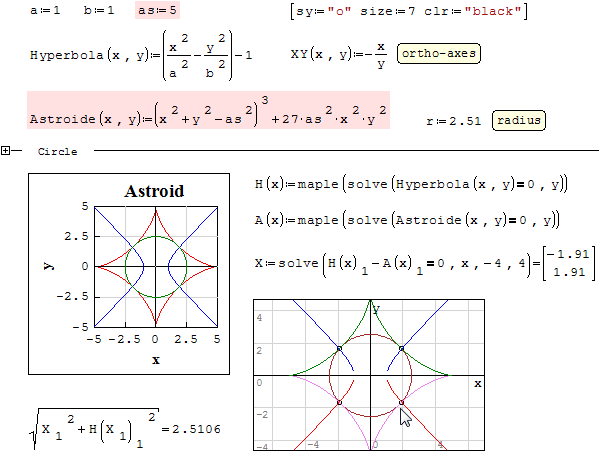

The intersection points of two curves
Primer1b.sm (33.88 KiB) downloaded 1432 time(s).
Primer1b.pdf (212.69 KiB) downloaded 793 time(s).

Fixed. Now you can find all the intersection points.
Primer2.sm (36.58 KiB) downloaded 1453 time(s).
Primer2.pdf (215.28 KiB) downloaded 798 time(s).

#34 Posted: 2018/8/23 10:57:07
... thanks Ber7
Contour SOLVE AstroidHyperbola.sm (20.85 KiB) downloaded 1459 time(s).

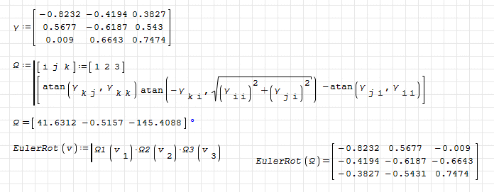

PD: Do you know the angles for your rotation matrix gamma? I get this, but can't put the matrix elements in the correct order nor sign:
Actually, as I know, the minus in the last atan is a mistake, but at least give the same absolute values.
Hi, Alvaro.
Unfortunately, I have never done reverse transformations (gamma-omega).
Your error may be caused by the use of the left coordinate system in Smath- graphs.
I selected the angles for the axial matrices empirically in order to get a good perspective ,using the gamma matrix.perspective.
Mathcad solves the Euler angles from a given γ [gamma matrix].
Smath does not immediately, it complains: Try to use a more specific algorithm.
There are 24 [4!] possible ways to define a 3D system [Mathematica].
The most common is Euler though Mathcad Mathcad ≠ Mathematica.
For common use to define some pleasant views, especially in Smath:
1. Euler [ 3 trig angles]
2. Parametric [X,Y,Z,t] very easy to manage.
3. Quaternion only two coefficients that Quaternion solves for the 3D γ matrix
Rotate Horn.sm (15.07 KiB) downloaded 1410 time(s).
Solve Euler Fails.sm (22.54 KiB) downloaded 1464 time(s).

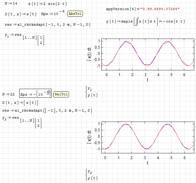

Updated.
Changes for al_rkckadapt():
- zero point issue fixed;
- added support for the simple D(t,x) definition.
