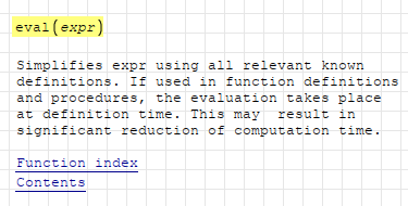

#18 Posted: 2021/12/23 11:45:18
Thank you for the very warm welcome, Jean.
Is there a reason why Dy is within in eval()?
I tried removing it in the function and the result looks the same.
Two typos in your 'chito' document: Manilla, Kota Kinabalu in Sabah.
You are right, no need to Dy:=eval(,) is so fast.
eval(,) applies to parse result as a numeric entity.
It breaks the chain calculation. Per application experimental.
The rule eval(,) is crucifying ... watch the demo attached.
from 65 s down to 0.015 s !!!
Take care ... Jean
Maths eval(,) TEST.sm (19.27 KiB) downloaded 1001 time(s).

#20 Posted: 2021/12/23 21:13:04
598 likes in 1,380 posts.
eval() makes computations faster most of time.
Very minor times, may have no effect or slows the calculation.
It would be wise to choose where and when to use it.
