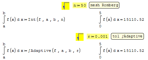

Integrate AdaptiveRombergKernel FIRST Tool.sm (152.26 KiB) downloaded 1083 time(s).
