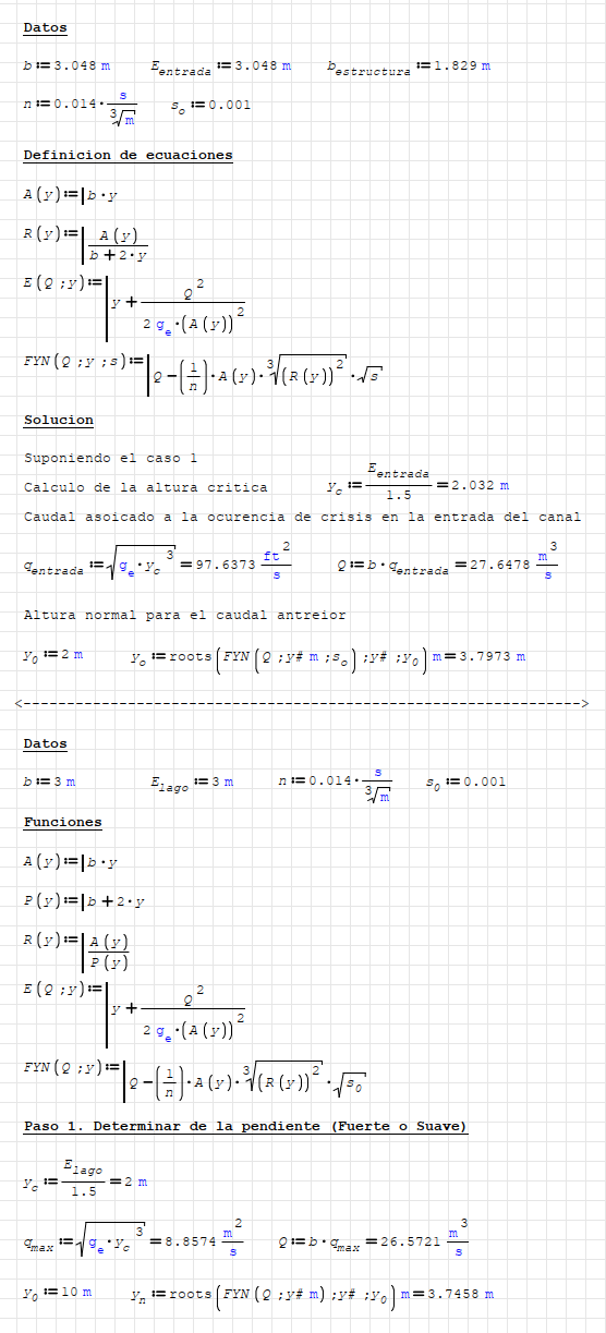

I need to pass these codes that are in Mathcad Prime to Smath, does anyone know how I can do it?

But the programming is the same in Smath? I mean, for example the FYN or root function still works?

Not same, but very similar.
calculo.sm (22.39 KiB) downloaded 1227 time(s).

Smath has many solvers. FYN from implicit roots(,,,).
roots will solve on the canvas [MACH number]
calculo Direct Code.sm (20.59 KiB) downloaded 1179 time(s).

Maybe off topic between overlord and Jean Giraud's conversation, but what's the difference between a function definition with line() and a definition with line() removed? Will there be a difference on how SMath calculates it?

...but what's the difference between a function definition with line() and a definition with line() removed? Will there be a difference on how SMath calculates it?
There will be a difference, a huge one actually.
When a variable is defined before function,
and that variable is used inside the function,
if line is used, variable redefine shall effect result.
if not used, variable redefine won't effect the result of function.
Which mostly we don't want not effecting, so using line() is better.
I mostly define function variables with unique naming. (# after variable for example)
So common used variable names won't effect function results.
This is my habit and I think it is a useful one.
This naming doesn't crowd pages or confuses people.
It is minimizing calculation errors caused by author.
f(x#;y#):=x#^2+2*y#

Is there a reason why Dy is within in eval()? I tried removing it in the function and the result looks the same.
Two typos in your 'chito' document: Manilla, Kota Kinabalu in Sabah.
You are right, no need to Dy:=eval(,) is so fast.
eval(,) applies to parse result as a numeric entity.
It breaks the chain calculation. Per application experimental.
The rule eval(,) is crucifying ... watch the demo attached.
from 65 s down to 0.015 s !!!
Take care ... Jean
Maths eval(,) TEST.sm (19.27 KiB) downloaded 1146 time(s).
