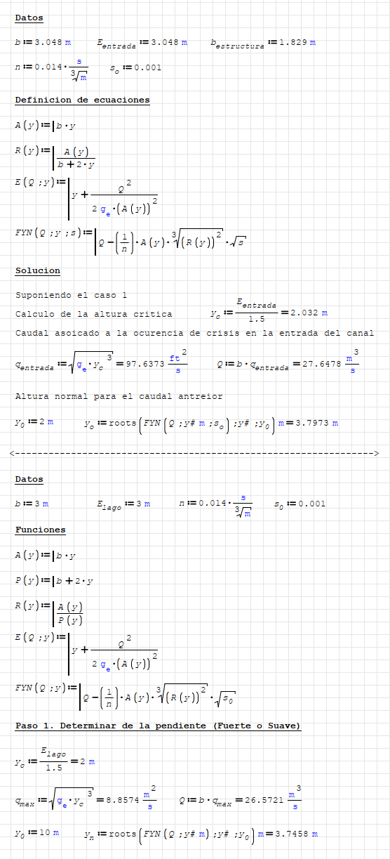

Maybe off topic between overlord and Jean Giraud's conversation, but what's the difference between a function definition with line() and a definition with line() removed? Will there be a difference on how SMath calculates it?
Cheers.
#15 Опубликовано: 22.12.2021 09:01:39
In short line | is a descending dependent collection.
Welcome to Smath Community ... Jean.
chito.sm (51,93 КиБ) скачан 1135 раз(а).
#16 Опубликовано: 22.12.2021 16:16:39
...but what's the difference between a function definition with line() and a definition with line() removed? Will there be a difference on how SMath calculates it?
There will be a difference, a huge one actually.
When a variable is defined before function,
and that variable is used inside the function,
if line is used, variable redefine shall effect result.
if not used, variable redefine won't effect the result of function.
Which mostly we don't want not effecting, so using line() is better.
I mostly define function variables with unique naming. (# after variable for example)
So common used variable names won't effect function results.
This is my habit and I think it is a useful one.
This naming doesn't crowd pages or confuses people.
It is minimizing calculation errors caused by author.
f(x#;y#):=x#^2+2*y#

Is there a reason why Dy is within in eval()? I tried removing it in the function and the result looks the same.
I think this is a very important point that I need to keep in mind. Using unique names in functions is also a great suggestion. Thank you overlord.
Cheers.
#18 Опубликовано: 23.12.2021 11:45:18
Thank you for the very warm welcome, Jean.
Two typos in your 'chito' document: Manilla, Kota Kinabalu in Sabah.
You are right, no need to Dy:=eval(,) is so fast.
eval(,) applies to parse result as a numeric entity.
It breaks the chain calculation. Per application experimental.
The rule eval(,) is crucifying ... watch the demo attached.
from 65 s down to 0.015 s !!!
Take care ... Jean
