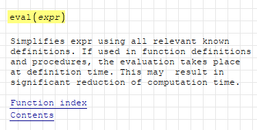

Is there a reason why Dy is within in eval()?
eval() makes computations faster most of time.
Very minor times, may have no effect or slows the calculation.
It would be wise to choose where and when to use it.

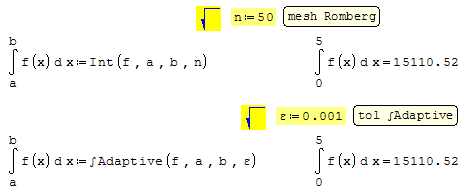

1. as well, you can recast the function name.
2. and use algo style to be more pro.
That's what I meant by recast, last page of the attached.
