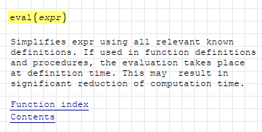

Is there a reason why Dy is within in eval()?
eval() makes computations faster most of time.
Very minor times, may have no effect or slows the calculation.
It would be wise to choose where and when to use it.

  • eval() for faster calculations

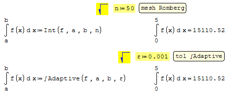

#23 Опубликовано: 26.12.2021 21:44:01
Interesting list and I like the explanation of "LINE". In addition, it took me a bit to understand using # in the variable name when I first started.
line | is typical of an algorithmic suite wrt a dependent program.
Download 2022 Samples ... see color(M).
The algo style I offered previously was not possible official SS 5346,
but possible from Un-Official SS 5346 from recollection.
Then came superb native Smath 6179.
#24 Опубликовано: 27.12.2021 12:32:32
1. as well, you can recast the function name.
That's what I meant by recast, last page of the attached.
Cheers ... Jean.
Integrate AdaptiveRombergKernel FIRST Tool.sm (152,26 КиБ) скачан 1165 раз(а).
#25 Опубликовано: 27.12.2021 17:19:04
#26 Опубликовано: 27.12.2021 17:41:45
