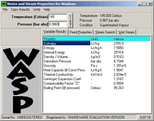

#27 Posted: 1/8/2017 12:41:22 PM
The user also asked for speed of sound and isentropic exponent functions. Is there a way to help him?
"WASP" is freeware for 10 minutes use, unlimited sessions.
"WASP" from "Katmar". all properties are tabulated per T(°C) or P(abs).

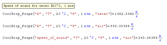

#28 Posted: 1/8/2017 3:58:05 PM
1,443 likes in 2,935 posts.
As for the speed of sound can be accessed using "A" or "speed_of_sound"
For the isentropic functions I googled "isentropic coolprop" and there is something but it is not my field, maybe Mike can give some hints.

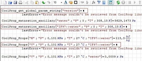

#34 Posted: 12/22/2017 9:39:02 PM
Aleksey
Aleksey
1 likes in 2 posts.
CoolProp_get_global_param_string("version"
lastError="Error message couldn't be retrieved from CoolProp library (buffer size issue?); the second try returned: "
what's the problem?
#35 Posted: 12/23/2017 5:47:39 AM
which versions of SMath and CoolProp plugin are you using?

#37 Posted: 12/25/2017 11:59:35 PM
Aleksey
Aleksey
1 likes in 2 posts.
Error:

#39 Posted: 12/27/2017 12:47:24 PM
don't working on
Win10x86Pro, Win10x86Educ, Win7x86Pro
Thank you, reproduced. Something goes wrong with the wrapped 32 bit library (the coolprop dll returns both the correct result as well as an error code, hence the errors shown).
