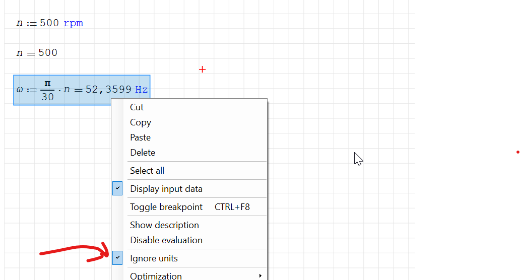

UnitaSilenziate.sm (2.88 KiB) downloaded 1174 time(s).

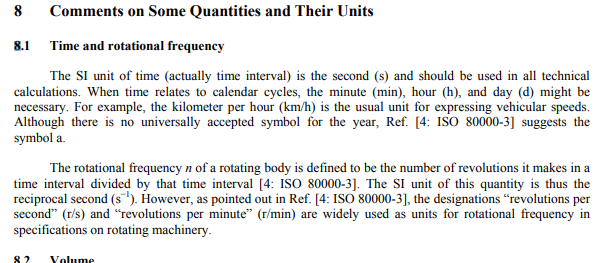

The NIST document (https://physics.nist.gov/cuu/pdf/sp811.pdf) defines rpm in chapter 8.1 as (rotational) frequency:
At the top of page 54, you will find the table caption
and further down the conversion factor.
Try to harmonize this with the Smath definition...
It is quite possible that in older textbooks rpm is defined contrary to today's SI usage.
But a modern program should perhaps conform to the current SI standard?

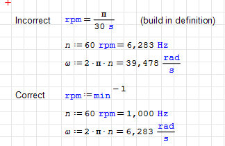

#17 Posted: 2021/9/22 14:14:51
Unit conversion may be challenging:
It is and it is more from a dead horse.
Plug my frequency meter in the grid 60 Hz, i.e: frequency
However, not from Smath !

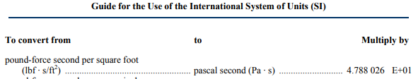

Overlord, you've misread the NIST conversion table. As listed on page 54 and again on page 67 at https://physics.nist.gov/cuu/pdf/sp811.pdf:
The table says:
Quote
To convert from:
rpm
To
rad/s
Multiply by
1.047198E−01
Note that the NIST table does not convert rpm to Hz, it converts rpm to rad/s. I've laid out the calculations to prove it below:
