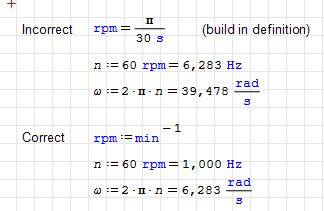

As you can see, Smath already stores "n" in Hz.
If you intend to convert manually then you have to do it correctly as shown here:

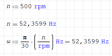

Thanks, it seems to work:
Is that the only possible workaround apart from not using units ?

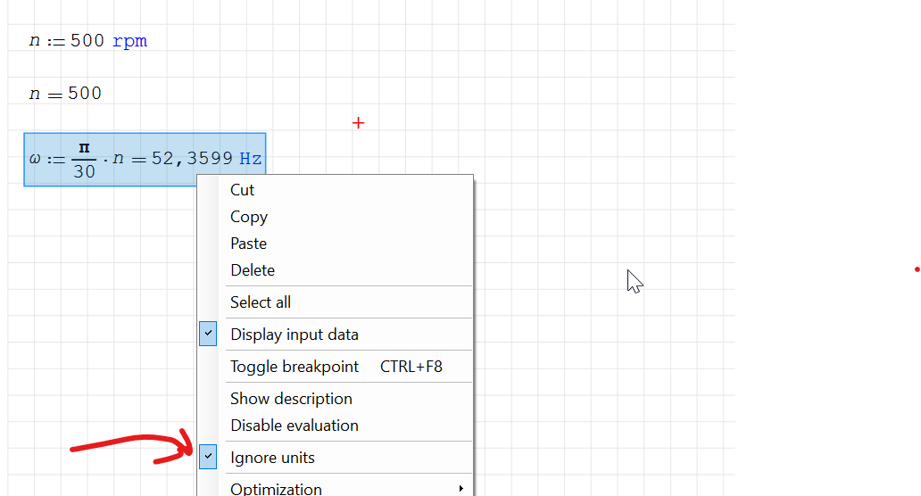

UnitaSilenziate.sm (2,88 КиБ) скачан 1341 раз(а).

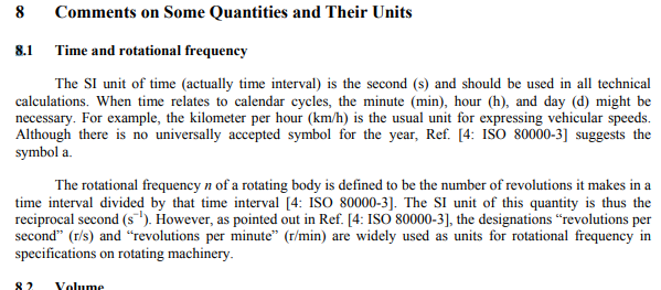

The NIST document (https://physics.nist.gov/cuu/pdf/sp811.pdf) defines rpm in chapter 8.1 as (rotational) frequency:
At the top of page 54, you will find the table caption
and further down the conversion factor.
Try to harmonize this with the Smath definition...
