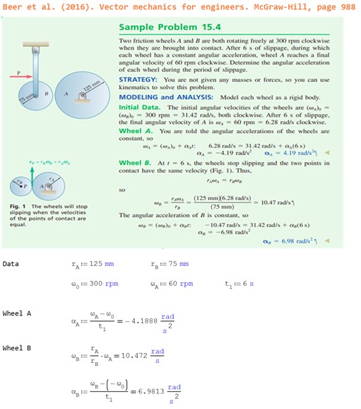

Hi. I'm quite sure this three guys think that rpm in SMath is well defined.
RPM_IN_PRACTICE.sm (562.47 KiB) downloaded 1162 time(s).

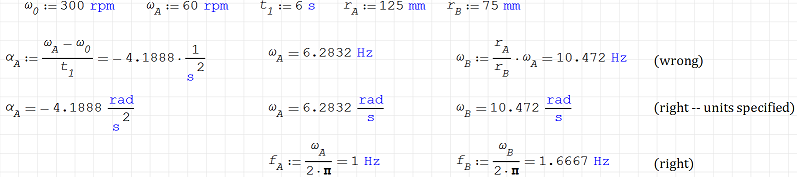

The following is the same calculation as the first example you provided, using the Windows Stable 0.99.7822 version of SMath (output units were not specified, except for the values on the line where it says "units specified" ).
One could specify "rad/s" as the units, and no change would occur, which is fine for the first example that you provided (because SMath assumes that rad/s and 1/s are the exact same unit -- which they are, for angular velocities ONLY -- again, this is because radians are unitless), but it is absolutely incorrect as soon as FREQUENCY is required. SMath treats angular velocity or angular frequency (rad/s) and frequency (Hz or 1/s) as equal, which they aren't.
ω = 2 π f ~~~~ That's: (angular frequency) = 2 * (pi) * (frequency)
If you have a piston attached to disk B, then the frequency of the piston is EQUAL TO the frequency of the disk (NOT the angular frequency). Smath would calculate the frequency to be 10.472 Hz (wrong), when it would actually be 1.667 Hz (right).
This is because of how frequency is defined: it is the reciprocal of period, and period is the time it takes for a measurable event to occur. Frequency is therefore the times per second that the event occurs.
For angular frequency only, the period is the time it takes to rotate through an angle of ONE RADIAN (~57.3°). In other words, seconds per radian. Angular frequency is therefore the times per second that the object rotates by ~57.3°.
For most other applications, the period is the time it takes for a rotating OR oscillating object to pass its starting position. In other words, seconds per revolution or seconds per oscillation (cycle). Frequency is therefore the times per second that a roating or oscillating object passes its starting position.
I don't have time to go through the other examples. I've got homework to do, and I've gotta figure out workarounds to make SMath behave as expected with frequency, since it DOESN'T handle rpm <> Hz conversions properly, as evidenced by the very simple statement below:

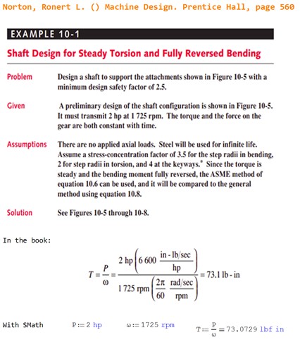

I don't specify units, I (and those three guys, if you don't know them, it could be a good read for introduce some basics) specify dimensions, not units. Radians are not unitless, they are an unit, are dimensionless, which isn't the same. For instance, masons, architects and civil engineers often measure the slopes of their angles in buildings in cm / m, quantities that are dimensionless but certainly have units.
Following your line of reasoning, you should tell Norton to correct his book, as his torque values (lbf-in) are badly wrong because he forgot to include radians. Or you don't measeure torques in energy units? Because I do. And Norton too.

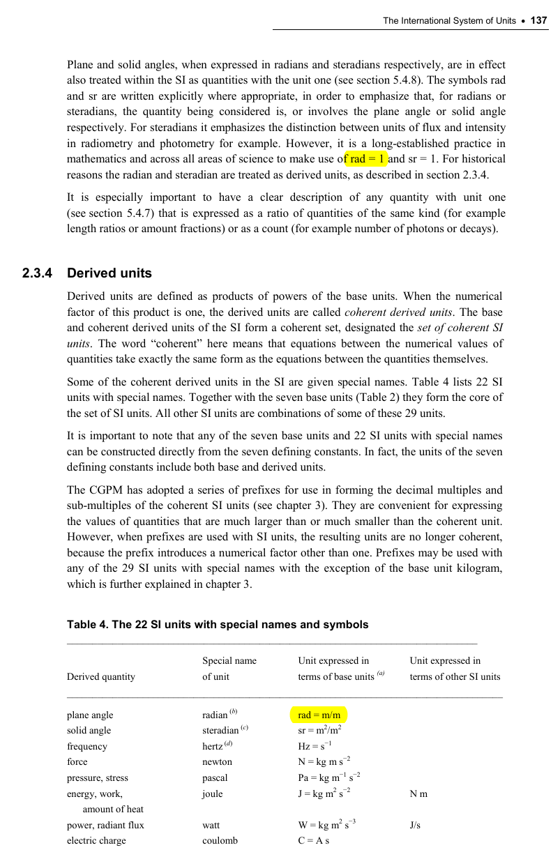

But Hz is a unit of (inverse) time. As far as I can tell, the SI standard ALLOWS for rad = (1) when used with Hz, but it doesn't define it as such. (In fact, it seems horribly obstinate about such a definition.)
I would argue that the "long-established practice ... of rad = 1" is equally as common as the understanding of Hz = 1 cycle/s (where, by SI definition, "cycle" is also dimensionless and thus cycle = 1).
It's clear from what I've read that both "1 rad/s = 1 Hz" and "1 cycle/s = 1 Hz" are acceptable by SI standards, and both have their uses, but when you says "This value is ___ Hz" to 99% of the scientific community, they'll assume you mean "This value is ___ cycles per second" (unless the context provides clues otherwise, such as when using ω or when speaking specifically about angular frequency, such as with torque).

See, that's the thing... this is seeming to be a lot more about "interpreting scripture" than it is about applying a concrete standard.
The section of the SI standard that you shared is precisely the section that I have been reading carefully and, by my best judgment, it merely states that both sides of this argument are right.
"make use of" is not the same as "exclusively use". ω is used commonly across math and science (and is most commonly associated with units of rad/s), while f is used just as widely (and is most commonly associated with units of Hz). It's so rare to conflate the two that, before now, I've never seen ω defined in units of Hz (though I have seen ω used, rarely, with rpm).
This paper sums up my meaning: Dimensionless units in the SI

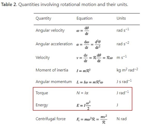

From your paper, here is the problem:
As I say before, all books are wrong with that convention. This is: Torque must to have radians. Can you imagine calculating a Lagrangian, or worse, an action integral, with those units?
