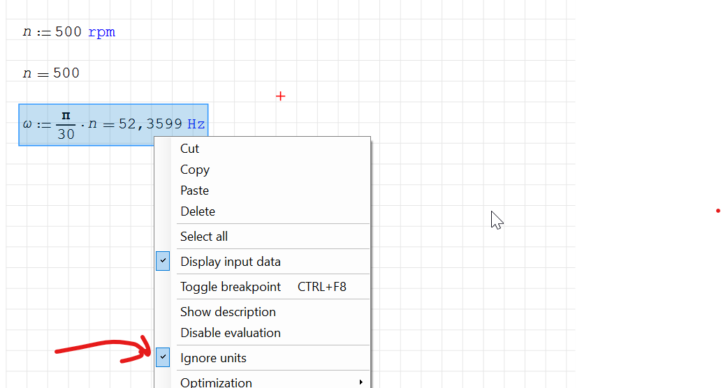

UnitaSilenziate.sm (2.88 KiB) downloaded 1341 time(s).

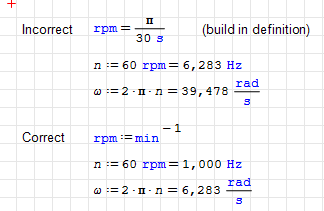

rpm is obviously wrongly defined in SMath.
The unit is revolutions per minute, not 2pi per minute.

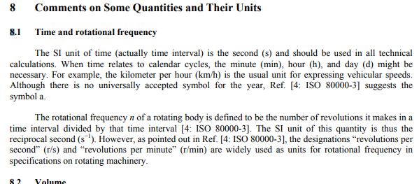

The NIST document (https://physics.nist.gov/cuu/pdf/sp811.pdf) defines rpm in chapter 8.1 as (rotational) frequency:
At the top of page 54, you will find the table caption
and further down the conversion factor.

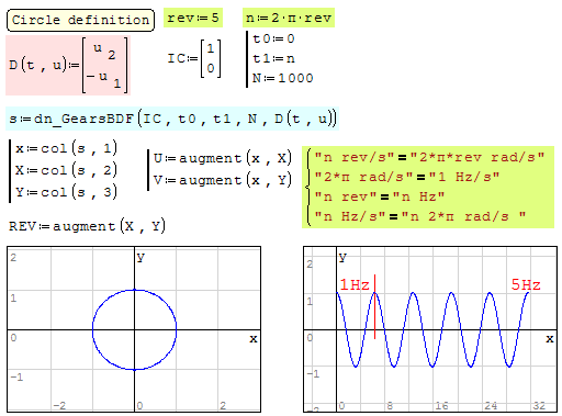

Plug my frequency meter in the grid ► 60 Hz, i.e: frequency
However, not from Smath !

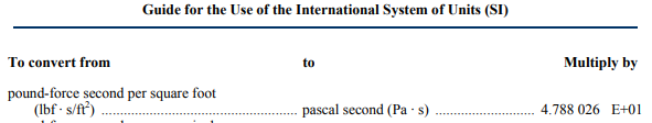

Overlord, you've misread the NIST conversion table. As listed on page 54 and again on page 67 at https://physics.nist.gov/cuu/pdf/sp811.pdf:
The table says:
Quote
To convert from:
rpm
To
rad/s
Multiply by
1.047198E−01
Note that the NIST table does not convert rpm to Hz, it converts rpm to rad/s. I've laid out the calculations to prove it below:
