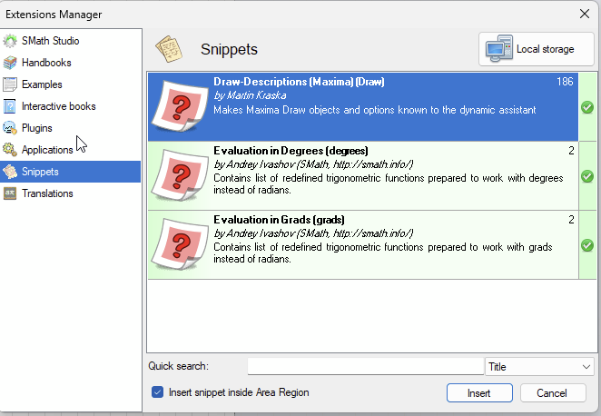

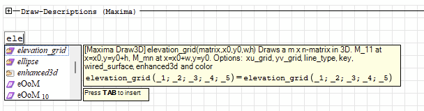

For the work with Maxima based 2D and 3D graphics, see the snippet Draw Descriptions

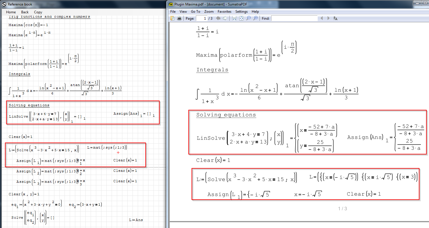

Plugin updated. Now Maxima should be started whenever required (this formerly failed at least for int())
EDIT: Update did just hide the problem, but did not solve it.

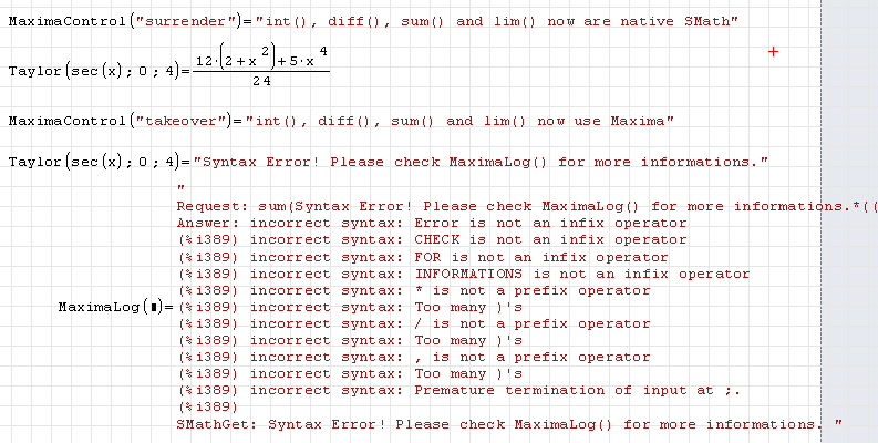

BUG/Dangerous feature:
Currently MaximaLog(), int(), diff(), lim() and sum() do not trigger start of a session!
Maxima must be started explicitly in order to take over the internal functions int(), diff(), lim() and sum().
Maxima session start can be triggered by one of
- any VALID MaximaControl() command (valid command strings are shown in the dynamic assistant)
- Maxima() with any argument accepted by SMath preprocessing
- one of the functions Solve(), LinSolve() or Algsys()
Make sure to re-calculate the document if you started the session by adding such a command into an active document.
This means that documents can behave differently depending on whether Maxima is running or not.
This is a bug/dangerous feature which we try to fix ASAP.
Meanwhile it is safe to stick to the recommendation in "Plugin Maxima.sm": Each document should at least do a cleanup at the beginning. This is to avoid interference between different open files in the same SMath instance and makes sure that Maxima is started. Use optimization> "None" or "symbolic" to see the "done".
MaximaControl("cleanup" )=done

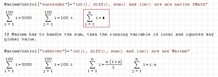

Maxima now does not overwrite the functions diff(), lim(), int() and sum(), because of the problems sum() and diff() can cause. Thus, we hope that Maxima now won't interfere with existing sheets as long as you do not ask explicitly by MaximaControl("takeover" ).
Plugin updated.
Maxima.sm (34.93 KiB) downloaded 2101 time(s).
- pi translation fixed
- sum() works but yet summation variables must be undefined
- logging and control improvements
- translation of scientific number format fixed
- translation of Maxima lists and lists of lists implemented (translated into matrices)
- SVN doc updated

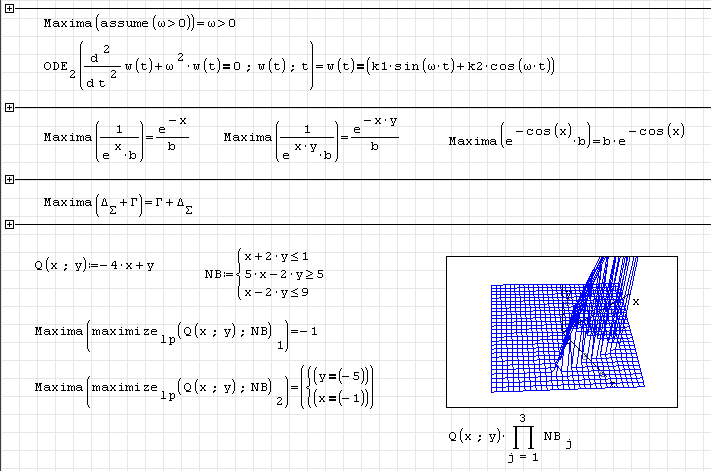

Plugin updated.
- Translation problem with unary minus in exponents solved (thanks to Leo Butler, one of the Maxima developers)
- Dedicated function ODE.2 for solving second order ODEs (wrapper for ode2())
- Bi-directional translation of greek uppercase letters
- Unidirectional (SMath to Maxima) translation of relational and boolean operators
- Improved error message forwarding

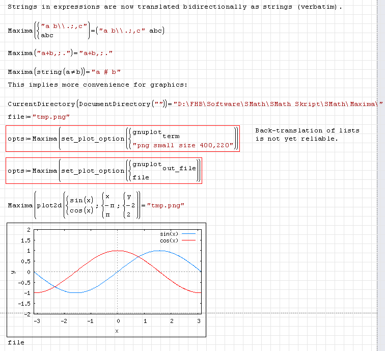

Plugin updated.
- Bidirectional transfer of string constants
-> more convenient plotting
-> Maxima string functions can be used
- Special markup for verbatim Maxima expressions ("$...$" )
- Special markup for quote character in MaximaLog() output
- Auxiliary files now reside in the plugin directory
- Bidirectional handling of different operator priorities in expressions like a^b^c or a^-b*c
