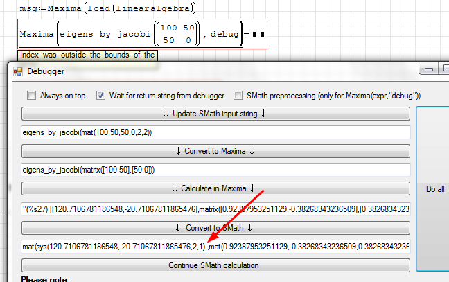

Radovan Omorjan 2014/1/3 04:57:00
You are welcome
I see your point in the drawing with many options and a problem related to them. I am not that experienced with this, and to be honest I forgot them constantly. It is impossible to memorize them. That is why we must have them available all the time.
At the moment just wanted to point out about the crashing problem of the few mentioned regions. If you have the patience just see these two videos.
Maxima crashes SMath
Debug - extra commas?
Or see the pictures, where I suppose might be a problem.
Martin Kraska 2014/1/3 05:24:00
Thanks, Radovan, I can reproduce the problem and forwarded it to Kay.

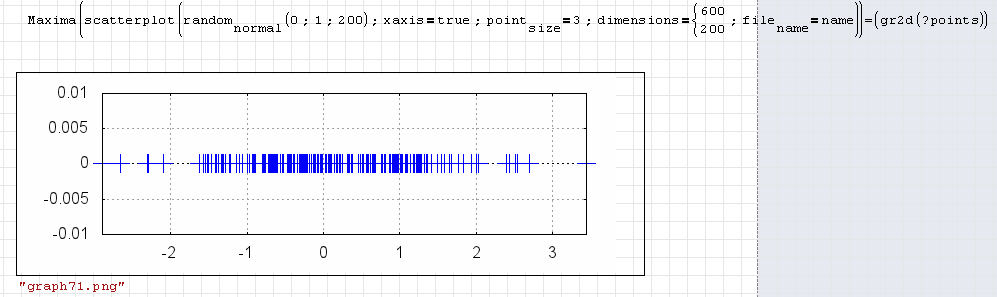

Here is a preview on how graphics could be supported in the Maxima plugin. In the attached sheet, the functions Draww2D() and Draw3D() are defined.
They take a list of options and objects as first argument, the output file name as second argument and optionally a two element list or matrix as size specification (defaults to 300x240 pixels).
Filenames can be given with .svg or .png extension, the output format is set accordingly. If no extension is given, it defaults to .svg. The functions return the actual name of the produced output.
For display, image regions are used. If the image region would evaluate the file name expression, the complete command for making the plot could reside in the placeholder and eventually be hidden. For now, the file name must be assigned to a variable and that variable must be put in the placeholder of the image region.
The attached sheet contains snapshot regions, as it was made to produce images for the pdf-handbook.
The examples in the attached sheet are mainly from the Maxima-Handbook, but also from the Plot3D plugin by uni (Klein bottle). The screenshots show the complete code required to produce the plots (except init like setting current dir to document directory and eventual reset of Maxima incl. loading of the draw package.
After some playing around and eventual feedback from the forum we shall implement the proposed functions in the Maxima plugin. Feel free to test and propose improvements.

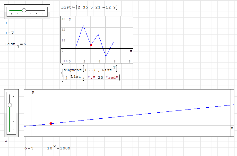

Radovan Omorjan 2014/2/11 02:29:00
Hmm...I can not find the Slider Region in the Extensions Gallery. Where it is? It is made by Davide but I could not even guess the password this time (as I usually do)?
WroteHmm...I can not find the Slider Region in the Extensions Gallery. Where it is? It is made by Davide but I could not even guess the password this time (as I usually do)?
Don't worry, will be relased ASAP :d
![2014-02-11 10_08_24-SMath Studio Desktop - [test.sm_].png](/zh-Hans-CN/files/Download/kMopHY/2014-02-11-10_08_24-SMath-Studio-Desktop---[test.sm_].png)
Radovan Omorjan 2014/2/11 07:09:00
I deactivated the sliders in the example. No need to ask the NSA for the password, it is not that strong. However (Davide, forgive me), I might trade it against hints on how to use the modeller region ;-)
