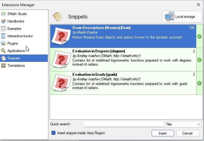

For the work with Maxima based 2D and 3D graphics, see the snippet Draw Descriptions

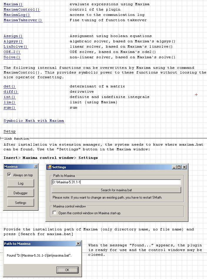

#3 Posted: 9/20/2013 11:03:39 AM
Due to registring a path to Maxima during setup, SMath is not really portable any more unless you can use the same Maxima path on different systems
[/list]
Thank you very much, Kay and Martin!!

As to the portable version. Honestly, I would rather focus on convenient and stable operation rather than on installation issues. If non-portability turns out to be prohibitive for otherwise active users, this, of course, should be handled.
But be aware that Maxima is as big as 30MB in download and 100MB unpacked.

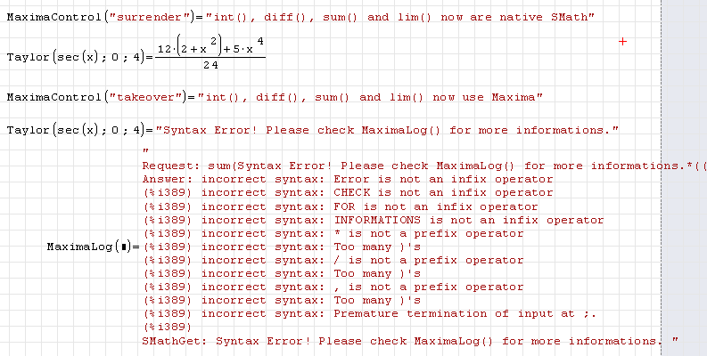

#8 Posted: 9/20/2013 6:24:54 PM
To create a Taylor series in a SMath worksheet one can write:
[MATH eng]Taylor(f(x),x.0,degree):line(T(z):sum((diff(f(z),z,n)*{(x-z)^n}/{n!}),n,0,degree),T(x.0),2,1)[/MATH]
Working from the plugin, NonlinearSolvers build the T(z) RHS, call a symbolic calculation and then replace with a C# while all the [MATH eng]z[/MATH] variables with [MATH eng]x.0[/MATH], this is made to leave clean the canvas from internal variables (but maybe there is another way that I don't know or that I've missed)... Maxima probably crashes against the while cycle (but I'm not sure)
Martin Kraska 9/20/2013 7:14:00 PM

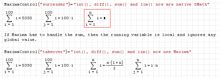

BUG/Dangerous feature:
Currently MaximaLog(), int(), diff(), lim() and sum() do not trigger start of a session!
Maxima must be started explicitly in order to take over the internal functions int(), diff(), lim() and sum().
Maxima session start can be triggered by one of
- any VALID MaximaControl() command (valid command strings are shown in the dynamic assistant)
- Maxima() with any argument accepted by SMath preprocessing
- one of the functions Solve(), LinSolve() or Algsys()
Make sure to re-calculate the document if you started the session by adding such a command into an active document.
This means that documents can behave differently depending on whether Maxima is running or not.
This is a bug/dangerous feature which we try to fix ASAP.
Meanwhile it is safe to stick to the recommendation in "Plugin Maxima.sm": Each document should at least do a cleanup at the beginning. This is to avoid interference between different open files in the same SMath instance and makes sure that Maxima is started. Use optimization> "None" or "symbolic" to see the "done".
MaximaControl("cleanup" )=done

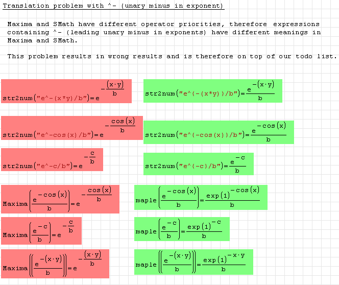

#17 Posted: 10/20/2013 1:08:24 PM
Serious translation problem with unary minus in exponents.
Currently, we see no easy way to mitigate that. The attached sheet demonstrates some alternative approaches but they all would involve more than just some regular expressions.
The reason is in the incompatible operator priority between Maxima and SMath, none of both sides can be blamed for that, except that the very low priority of unary minus in SMath is really unusual and is cause of other problems (try displaying -10°C).

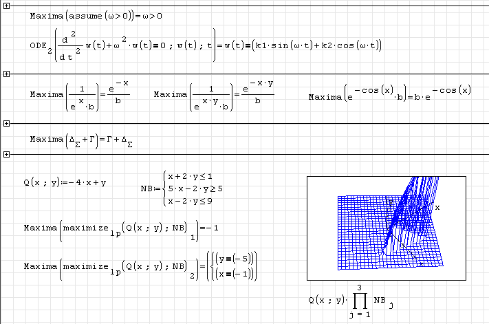

#18 Posted: 10/27/2013 1:57:00 PM
Plugin updated.
- Translation problem with unary minus in exponents solved (thanks to Leo Butler, one of the Maxima developers)
- Dedicated function ODE.2 for solving second order ODEs (wrapper for ode2())
- Bi-directional translation of greek uppercase letters
- Unidirectional (SMath to Maxima) translation of relational and boolean operators
- Improved error message forwarding
Radovan Omorjan 10/27/2013 3:29:00 PM, sergio 10/27/2013 2:46:00 PM, Andrey Ivashov 10/27/2013 3:29:00 PM

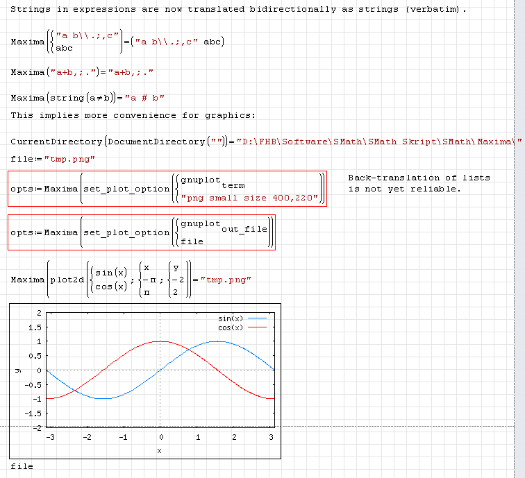

#19 Posted: 11/9/2013 1:11:01 PM
Plugin updated.
- Bidirectional transfer of string constants
-> more convenient plotting
-> Maxima string functions can be used
- Special markup for verbatim Maxima expressions ("$...$" )
- Special markup for quote character in MaximaLog() output
- Auxiliary files now reside in the plugin directory
- Bidirectional handling of different operator priorities in expressions like a^b^c or a^-b*c
