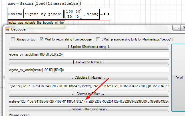

I just tried your example file. It crashes my SMath, but never mind. I copied parts of your file into another one to see what causes the problem.
I just wanted to thank you for stats package. It seems it is working
. The results are put in the system as you presented in your example.
Resizing of svg plot example is working for me as well. At the moment I do not know the details of it and how to use it for other plots using draw package, but never mind - I will figure it out sooner or later.
It seems that the problem and crash of SMath appeared just at the beginning of your example (linearalgebra regions also did not produce output). I copied the regions and "stack empty" errors appeared sometimes, sometimes crash happened. It does not look that those regions should cause problems. Actually, only by disabling the calculation of the first two math regions in your example (these first two like in the picture will suppress the SMath crash - calling functions from linearalgebra will still fail).
See the picture and the log file please.
Maxima.zip (814 B) downloaded 575 time(s).

#45 Posted: 1/2/2014 7:01:04 PM
Radovan, thanks for the feedback.
I don't know what could be the cause for the crash. You might try
- to close and re-open SMath
- to verify that you have the most current version of the Plugin (there were 2 bugfixes in the Gallery in the last two days.
- you might try the binary from SVN (under bin/debug)
- you might try to call the debugger from the Maxima command by adding a second argument: Maxima(...;debug) and go through the steps of the translation process.
As for the plot commands: Now, most of the Maxima handbook plots should be reproducible in SMath without error messages. To learn plot control, best is to try the Maxima handbook examples. If there are any problems with translation from Maxima to SMath input, let me know.
For the gnuplot preamble commands, see the gnuplot documentation. I found the example page quite helpful.
In order to be really user-friendly, we would need sort of control dialog similar to Mathcad with fast and obvious access to the options. Also, mouse interaction should be as extensive as possible. But that would require a custom region with either Maxima or directly gnuplot in the background.
For now, I could imagine to set up some support functions of the type
Draw2D(opt_list,...)=filename, where filename is a unique random name. Putting this directly into the ImageRegion placeholder would make up a rather comfortable and yet flexible arrangement.
Section Maxima Plotoptions Draw.sm (126.32 KiB) downloaded 1797 time(s).

#46 Posted: 1/3/2014 5:05:31 AM
You are welcome
I see your point in the drawing with many options and a problem related to them. I am not that experienced with this, and to be honest I forgot them constantly. It is impossible to memorize them. That is why we must have them available all the time.
At the moment just wanted to point out about the crashing problem of the few mentioned regions. If you have the patience just see these two videos.
Maxima crashes SMath
Debug - extra commas?
Or see the pictures, where I suppose might be a problem.
Martin Kraska 1/3/2014 5:24:00 AM
#47 Posted: 1/3/2014 5:26:25 AM
Thanks, Radovan, I can reproduce the problem and forwarded it to Kay.

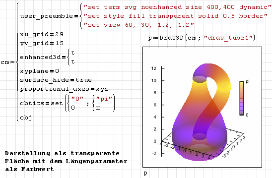

Here is a preview on how graphics could be supported in the Maxima plugin. In the attached sheet, the functions Draww2D() and Draw3D() are defined.
They take a list of options and objects as first argument, the output file name as second argument and optionally a two element list or matrix as size specification (defaults to 300x240 pixels).
Filenames can be given with .svg or .png extension, the output format is set accordingly. If no extension is given, it defaults to .svg. The functions return the actual name of the produced output.
For display, image regions are used. If the image region would evaluate the file name expression, the complete command for making the plot could reside in the placeholder and eventually be hidden. For now, the file name must be assigned to a variable and that variable must be put in the placeholder of the image region.
The attached sheet contains snapshot regions, as it was made to produce images for the pdf-handbook.
The examples in the attached sheet are mainly from the Maxima-Handbook, but also from the Plot3D plugin by uni (Klein bottle). The screenshots show the complete code required to produce the plots (except init like setting current dir to document directory and eventual reset of Maxima incl. loading of the draw package.
After some playing around and eventual feedback from the forum we shall implement the proposed functions in the Maxima plugin. Feel free to test and propose improvements.

Improved version of the functions Draw2D() and Draw3D(). It is now easier to use gnuplot preamble commands (no need to include the internal terminal settings).
In the attached files there are some more example plots.
Maxima-draw-filledcurves.sm (40.42 KiB) downloaded 1768 time(s).

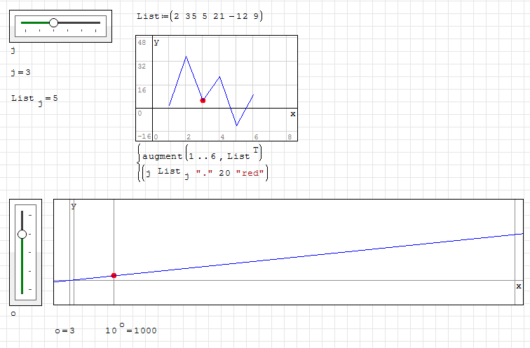

#51 Posted: 2/11/2014 2:31:55 AM
Hmm...I can not find the Slider Region in the Extensions Gallery. Where it is? It is made by Davide but I could not even guess the password this time (as I usually do)?
#52 Posted: 2/11/2014 5:07:26 AM
WroteHmm...I can not find the Slider Region in the Extensions Gallery. Where it is? It is made by Davide but I could not even guess the password this time (as I usually do)?
Don't worry, will be relased ASAP :d
![2014-02-11 10_08_24-SMath Studio Desktop - [test.sm_].png](/en-US/files/Download/kMopHY/2014-02-11-10_08_24-SMath-Studio-Desktop---[test.sm_].png)
Radovan Omorjan 2/11/2014 7:09:00 AM
