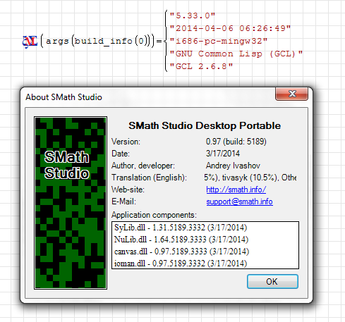

Here is a new preliminary portable SMath+Maxima version.
Improvements:
- Changed to Maxima 5.33.0 (works with draw)
- restart of Maxima should be possible
- X-Maxima not involved any more
Remaining problems:
- Absolute path to maxima must be used in Maxima settings (has to be changed if USB drive letter changes)
Install:
Unpack the zip file in the root dir of your USB drive
Usage:
- start SMath at SMath\2014...
- make sure the path to maxima is set correctly: Insert> Maxima> Settings: Specify absolute path to maxima (Drive:\SMath\Maxima-5.33.0.1 should do)
We try to go with relative path name in order to avoid the mentioned adjustments. Please report any issues.

Unfortunately, this is not working for me as well
I changed the path with Insert>Maxima>Settings.
C:\Users\omorr\Downloads\Software\SMath\SMath\Maxima-5.33.0.1\bin\maxima.bat
Path is correct, I checked twice.
But now, restarting Insert>Maxima>Settings or MaximaControl(restart) will simply freeze the Start Maxima window and not starting Maxima. Will try some more to some other computers.
[EDIT] I put it now on the USB stick
F:\SMath\Maxima-5.33.0.1\bin\maxima.bat
Strange, but now it works
. But I am not sure if this would work on another computer (No Smath, No Maxima) and if this would be portable. I could see that Temp folder on the stick was used for temporary plot files. Here is my maxima.bat file. I hope that it should be this way.
[EEDIT]
I tried right now the stick to another computer (No SMath, No Maxima) and it works

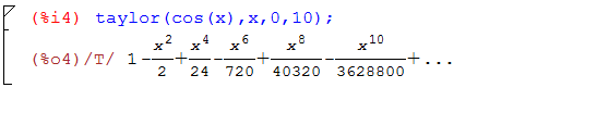

I've just restarted SMath after a break of a couple of years and am finding the Maxima plugin is the best thing in SMath since I last used it.
I do however have a minor problem. When doing a taylor expansion, the expression displayed by SMath is being factorised. This is quite annoying for me and I would like to know if there is a way to display the expansion is the standard format as displayed by Maxima. See below.
SMATH output
Maxima Output
SMATH output
Maxima Output
SMath Optimization should be suppressed when using Maxima plugin. Right click on the Maxima region and choose Optiization|None
[MATH=eng]Maxima(taylor(g(x),x,0,10))=1-{x^2}/2+{x^4}/24-{x^6}/720+{x^8}/40320-{x^10}/3628800[/MATH]
