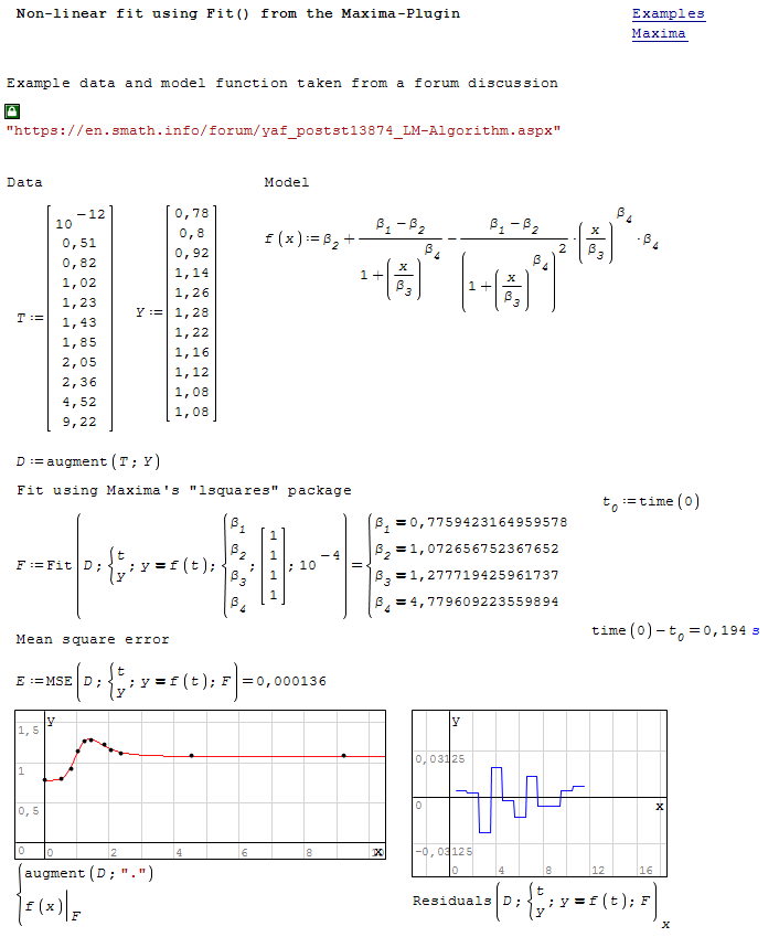

#250 Posted: 2018/9/21 21:55:04
1,355 likes in 2,271 posts.
Example application for Fit(), MSE() and Residuals() and efficient plotting.
Example Fit.sm (13.62 KiB) downloaded 1454 time(s).
Radovan Omorjan 2018/9/22 03:02:00, Вячеслав Мезенцев 2018/9/22 02:15:00, frapuano 2018/9/22 08:26:00
#251 Posted: 2018/9/22 03:36:05
Thank you Martin,
I tested it briefly with a larger data set and more than one dependent variable. At a first glance it seems that it works surprisingly fast. I might have forgotten but I think there is not yet a strictly numerical procedure in SMath (available via plugin) for nonlinear fitting a quite large data set to a function with multiple dependent variables.
#252 Posted: 2018/9/22 08:13:04
1,123 likes in 1,795 posts.
In the attached, the functional version of the Carlos' version of LM. For some large set of data, as Omorr ask, the main problem it's the Jacobian. There are some algorithms that don't use it. In this approach, actually it's a truly mix of numerical and symbolic manipulation for the Jacobian.
lmCarlos.sm (57.8 KiB) downloaded 1448 time(s).
frapuano 2018/9/22 08:26:00, Radovan Omorjan 2018/9/22 10:36:00

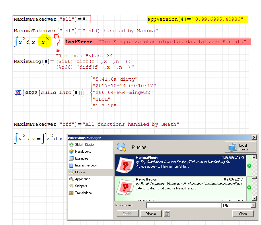

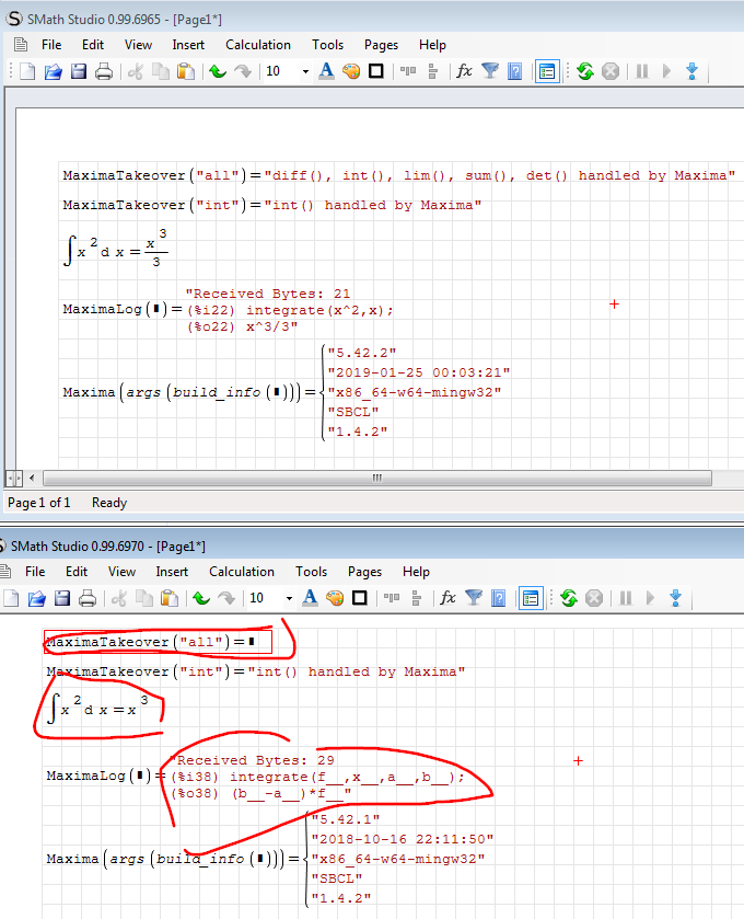

#253 Posted: 2019/2/25 20:00:58
Severe problems since SMath build 6970. Last version tested ok is 6965.
maximaproblem.sm (4.28 KiB) downloaded 1474 time(s).
#254 Posted: 2019/2/26 04:03:40

#256 Posted: 2019/3/6 04:29:41
The problem remained unsolved
However, it seems that Det(),Diff(),Int(),Lim(),Sum() are working well.
#257 Posted: 2019/3/6 10:27:27
Int() certainly does not work.
Why bother Maxima, unless some like that cluster fuck
#258 Posted: 2019/3/6 12:35:51
2,340 likes in 4,041 posts.
Plugin updated. Please try.
Martin Kraska 2019/3/6 15:41:00, frapuano 2019/3/6 17:28:00
#259 Posted: 2019/3/6 15:14:38
I think it is all right now. Thank you.
#260 Posted: 2019/3/6 15:40:46

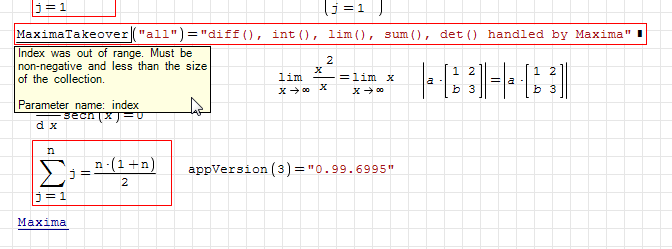

I confirm that the API issues seem to be resolved. Andrey, thank you very much, I might not have been able to fix that soon.
In the test suite (Plugin maxima test.sm in the interactive handbook) there is just a new issue with displaying svg images in the Maxima-Draw-Region and in the image region. PDF and PNG work fine though.
Best regards, Martin
